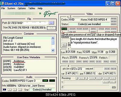

    I want to cut the title portion which runs for about 3 to 4 minutes in AVI-XviD format movies. Can I do it right from the 1st frame or is there any restrictions to keep some frames from the start so that the mandatory data, if any, are not removed. I have no idea about this. Why do I ask this, coz, after removing the title, the details of the structure are not shown but a message appears in GSpot. However, the structure was seen before the cut.

    Yes. I did the cut as described but in Avidemux. The beginning was not at I frame, but at an intermediate frame. So, when asked for a smart copy encoding, I accepted it with quantiser 4 as suggested by the program. After the cut, the structure indicating I, B, P frames etc. are not shown in Gspot. Please see the attached screenshot at the first post. That's why I want to know if I should not make the cut at the beginning.

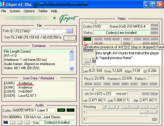

    Thanks jagabo for your instant reply. I could trim away a portion at the beginning with smart copy. I wanted to see the structure of the file after effecting the cut in gspot. It only shows "AVID". When I move the cursor over it, a highlighted message appears. I don't understand what it means. Could I get some explanation please.
