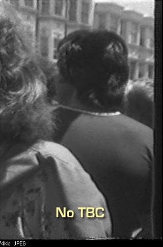

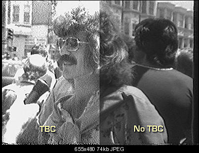

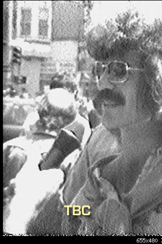

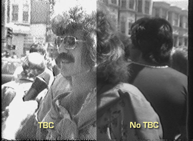

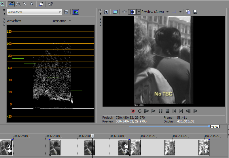

    I am working on a reel of EIAJ videotape that is a mere 38 years old. The technical production was poor to begin with and the video is quite unstable. When I go straight into the ADVC110, I get good video levels but lots of dropped frames. So I tried the AVT-8710 TBC. It follows the signal much better, but the levels are blown way up toward white. The processing controls on the 8710 don't help much. Any suggestions? Would a fancier proc amp help?

  2. Member edDV's Avatar
    Mar 2004
    Northern California, USA

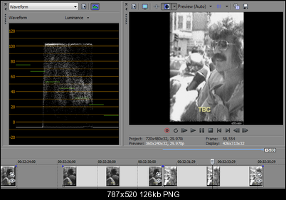

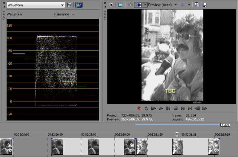

    The original had somewhat high black level
    The TBC output has way high gain causing raised black levels and white clipping. There must be a gain control on that TBC or there is a missing termination.
