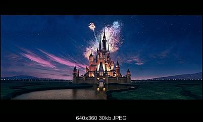

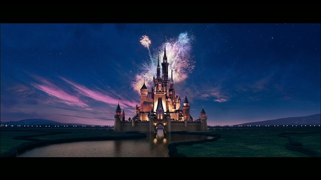

    Also, I can see a problem with the aspect ratio/image proportions - but I'm not sure if this is caused by your WinTV card:
    - Mediainfo reports the display aspect ratio as 16:9; if I take the images you uploaded and convert them to a resolution of 640x360 (16:9 -square pixels) the castle is distorted and the sides are missing when compared to this reference image, which I believe is accurate*:
    *I tried to pause the video at the same place as the second image you uploaded.
    The resolution of the files (720x400), is close to a 16:9 picture with 'square pixels' - as opposed to an anamorphic 720x480 picture with non square pixels. I'm guessing that the videos have been converted from a DVD.
    Converting videos to use square pixels is recommended - so the res. you're using should be ok.
