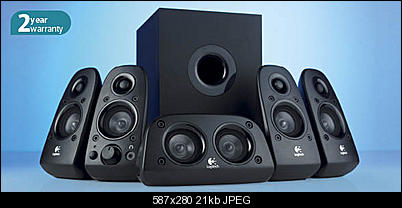

    Just bought myself a good bargain with these speakers on special offer at the local supermarket:
    Logitech Z506 5.1 Speakers

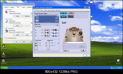

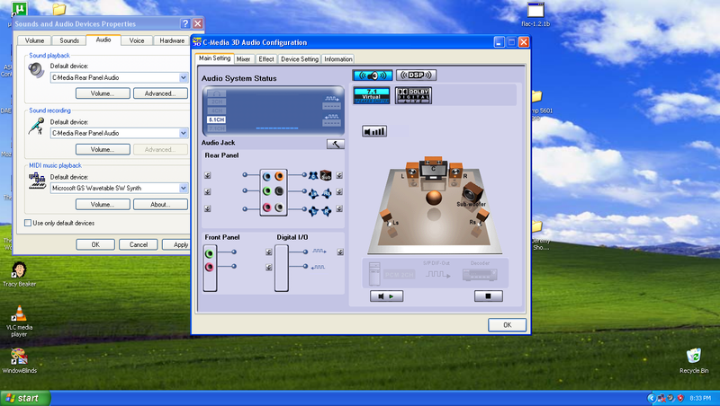

    Unfortunately part of the soundcards software is a liuttle confusing for e and im not sure if anyone else is familiar with this kind of thing?
    Below is a picture.
    I'm a little confused at this point.. I have selected what i can only guess to be the correct settings but listening to the "left surround" speaker it sounds quite distorted, quieter and very crackly.
    As you can see on the left pane there are 6 colour coded outpot jacks.
    I'm using only the ones on the right, first of all are those the ones to be using?
    2ndly what does each colour represent?
    Does the orange represent say the subwoofer? Does the black represent the L & R? Or does black represent left surround and right surround? Really not sure but id really like to ocnfigure them to work how they are supposed to as so far yes the left and right surround do work but are quieter than the left and right front ones and crackle a lot at me too.
    The film being played back is on VLC and is set to 5.1 audio which is correct as these speakers are 5.1, I have changed to settings in windows also to 5.1 instead of 'desktop stereo speakers'
    Perhaps if any of you know you could point me in the right direction for the relivent settings on this screenshot that i'd need to do?
    If the info is of any help to you the sub woofer itself has a green stereo jack input aswell as the orange and black one next to it. The PC has the 6 on it identical to the one on the picture.
    Pls help guys im desperate 2 get this up n going.
    Thank you
    Oct 2005
    666th portal
    the plugs used are stereo mini jack just like on a set of headphones. each wire carries to channels. make sure the jack is inserted completely at both ends.
    orange center and sub. black would be the l and r front. white l and r rear.
