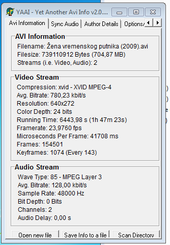

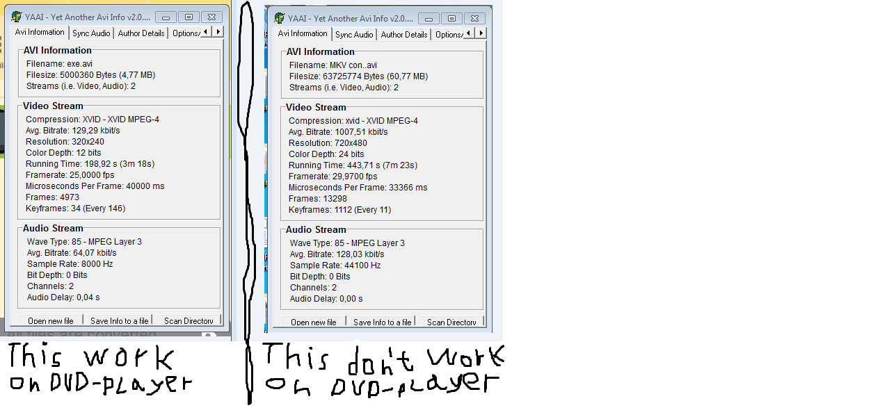

    Its all in picture, i dont get it, the same AVI files but still, right one wont work on DVD/DivX player.
    Do you now why?
    P.S I dont think its got anything with resolution because, one other movie with resolution 640x480, wont work the same.
    thanks!

    It could use gmc or qpel xvid settings that is not supported on many players. See https://forum.videohelp.com/threads/295067-Common-DivX-DVD-Players-AVI-Playback-problems! .
    Easiest is just to reconvert with avi recomp.

    The resolution and bitrate are higher on the right. What are the specifications for xvid files for your dvd player? It should handle the one on the right since it is standard definition. However perhaps it only accepts 640x480 or smaller resolution in xvid? And the bitrate might be too high also.
  4. DivX players should accept all standard resolutions; Maybe it isn't muxed properly can you try and remux either with avimuxgui or avidemux?

    https://www.videohelp.com/tools/MPEG4_Modifier . Browse (your .avi) ... Unpack (mark) ... Save (.avi new name) and Voila !
  7. Use GSpot to examine your Xvid AVI files. It shows a lot more information like GMC, QPel, B-frames, packed bitstream.

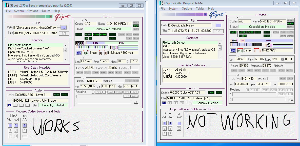

    Probably your files that don't work use encoding options that your DVD player doesn't like. See here:
    https://forum.videohelp.com/threads/290800-My-DivX-DVD-Player-can-t-play-my-avi-DivX-xvid-video
    YAAI is NOT helpful at all. Post information from GSpot if you want us to look at your problem videos.
  10. Ok, now its in gspot i hope that helps.
  11. What do you mean by not working? Does the player show the file in the menu list? Does it try to play it? Does it play but gets jerky at times?
    Some things to look for: See if any of the files that play properly have AVID, DF, and AC3 audio. Most of the other settings that can cause problems aren't used in your "bad" file (GMC, QPel, too many b-frames, packed bitstream, high bitrates, high frame rates, large frame sizes, etc.).
  12. the player show the file in the menu list, and when i want to play it, it trys but nothing happens.
    Files who can play have AC3 and mp3, same as does who wont play.
    Do you know some video converter with who i could have same result as with does files that work ?
