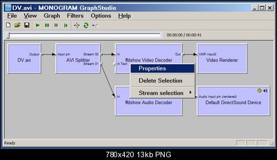

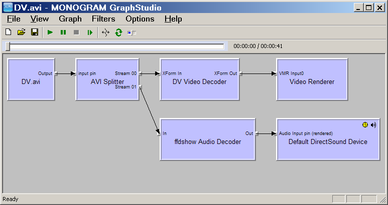

  3. If you have GraphStudio try dragging your DV AVI file onto it's main windows. That will build a filter graph. You can look at the properties of each of the filters for hints about what's going on (right click on any filter and select Properties). Especially check the output of the DV decoder and the input of the renderer.

    You can play the video from there by pressing the green play button. Does it deinterlace properly?

    Ok... I ran the file through that program. Here's what it gave me:

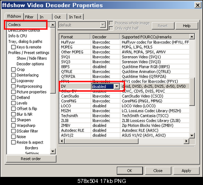

  5. That shows you that ffdshow is doing your DV decoding, not Microsoft's QDV.DLL. Disable ffdshow's DV decoding:
    Start -> All Programs -> ffdshow -> Video Decoder Configuration -> Codecs (left pane) -> DV (right pane, set to Disabled)

  7. Right click on the ffdshow filter in GraphEdit and select Properties.

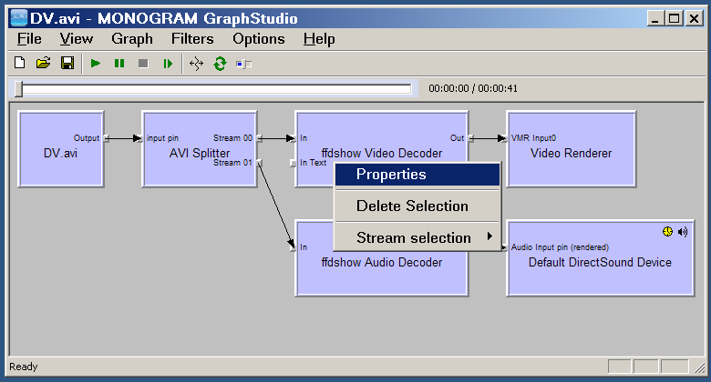

  12. Start GraphStudio. Drag a DV AVI file onto the GraphStudio window. It will create a graph. Right click on the ffdshow filter and select Properties:

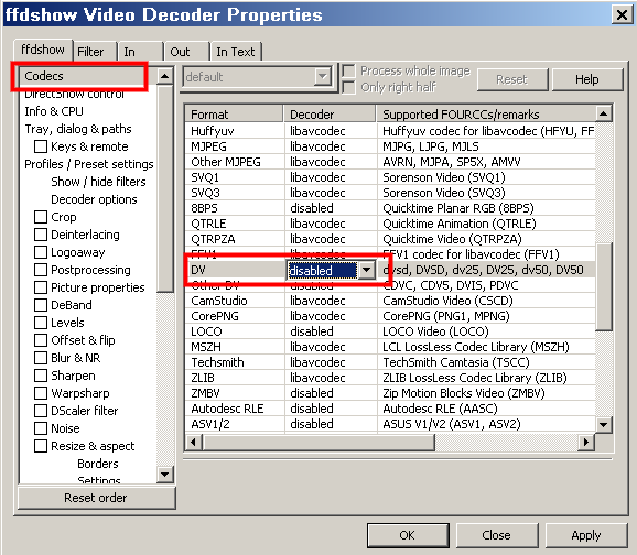

    In the ffdshow properties dialog select Codecs in the left pane and disable DV AVI:

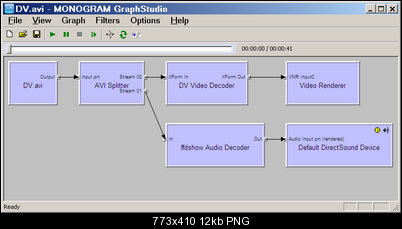

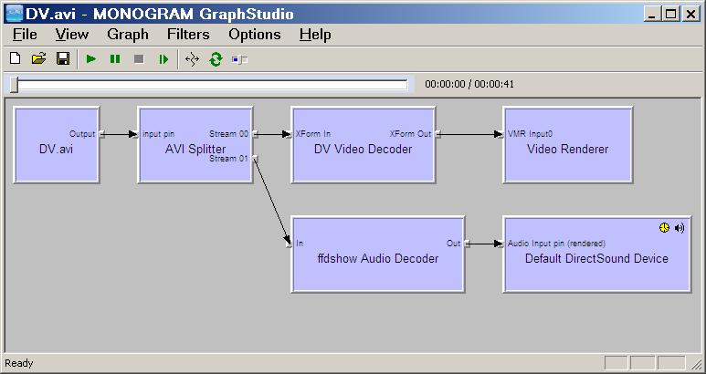

    Drag the DV AVI onto the GraphStudio window again. The ffdshow filter should not longer show up:
    "DV Video Decoder" is Microsoft's DV decoder, QDV.DLL. If ffdshow continues to show up I have no idea why. Check to see if it still shows as disabled. If not, try again. If it keeps coming back as enabled something is screwing with your system.

  16. What about the AVI File Reader (left-most filter) and the AVI Splitter (the next filter)? If you right click and select Properties do they show quartz.dll as the filename?
    Right click on DV Video Decoder and select Properties. Go to the XForm Out tab. In the VIDEOINFOHEADER2 section what does it show for dwInterlaceFlags?
    Right click on Video Render and select Properties. Go to the VRM Input0 tab (or whatever Input0 is named). In the VIDEOINFOHEADER2 section what does it show for dwInterlaceFlags?

    In both the AVI File Reader and AVI Splitter filters, quartz.dll is the file specified.
    In the VIDEOINFOHEADER2 section, it shows a value of 0x00000081 for dwInterlaceFlags.
    In the Video Render box - Properties - VRM Input0 - VIDEOINFORENDER2 section, the value for dwInterlaceFlags is 0x00000081.
  18. Those are the same filters and flags I see on my system. I'm out of ideas.
