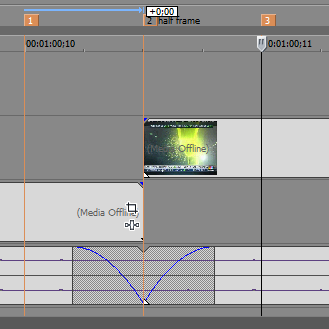

    Apr 2007

    Unlike Pro, 59.94 isn't in the drop down settings but if you type in 59.94, the setting will take.
    half frame timeline

    Now, if you output this as 60i, you will get combed fields.
    If you output as 30p, you will get blended fields in the transition frame.

  11. Originally Posted by edDV View Post
    Did you try changing project setting to 59.94 fps?
    You can change project settings with this button
    [Attachment 6097 - Click to enlarge]
    Yes, and it worked! Thank you! Thank you so much!
    But...there's just one teeny, tiny, little, problem.
    There's a little bit of space between the clips. Although I'm not sure if you could see it with this particular screenshot, lol.
