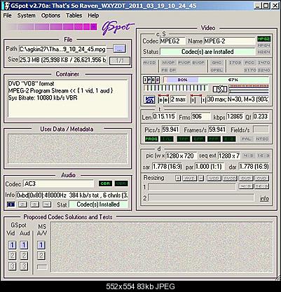

    I was using DgIndex and an Avisynth script in VirtualDub to look at a TV recording; it has four repeats of each frame.
    Usually recordings from this station show a two repeat sequence.
    Can anyone tell me why they would be different.

  2. The type of recording hardware and the Avisynth script might be helpful in determining what the problem is.
    If this is an animation, many of these are only 12 FPS with all dupes removed.

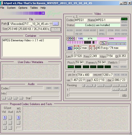

    Here's the source .wtv information.
    [Attachment 6082 - Click to enlarge]
  6. Your source was progressive 1280x720 59.94 fps with every frame repeated twice. Then SeparateFields() is splitting each of those frames into two half height frames, doubling the frame rate and distorting the aspect ratio.

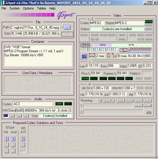

    Why is it repeated in the one case - but not in the one below.
    http://www.mediafire.com/?u19cftex5awy73v
    I'm not interested in processing the videos - I wish to know the reason for the differences in the sources since they are recorded from the same HD channel.
  8. The first video was made from a source that only had 30 unique frames per second. (Because of the low resolution I suspect it was originally 480i with 60 unique fields per second, deinterlaced to 30 frames per second, then upscaled and frame duplicated to 60 frames per second.)
    The second video was made from a source with 60 unique fields or frames every second. I suspect it was originally 1080i (60 unique fields per second), bob deinterlaced to 60 frames per second, and downscaled to 720p for broadcast.
