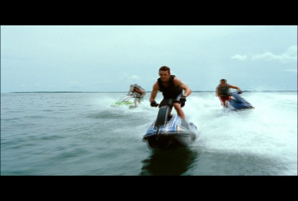

    Ive joined the forum to get a little bit of help from some clued up video people. Basically Im going for job as an AV engineer (entry-level / full training provided) and Im mainly an audio guy. Its definitely my strong suit but I have picked up a reasonable amount of video skills along the way. So after getting through the first round of recruitment (i.e. CV) they have emailed me a simple test with 3 still images from videos asking me to identify the problems. Im pretty sure I know the answer for 2 of them but am a little unsure on the first one. In short Im going to post the three images and my answers to them and would like some feedback from people if I am correct and if not some advice / knowledge / links to knowledge so that I can see where I am going wrong. See attached Images.
    Image 1 - This is the one I am unsure about. I think it is originally a 16:9 vidoe that has been converted to 4:3 (the frame we are looking at is definitely 4:3 right?) This has created the letterboxing on the top and bottom of the screen. It also looks like it has been stretched vertically thou as well. Like I said very unsure about this one.

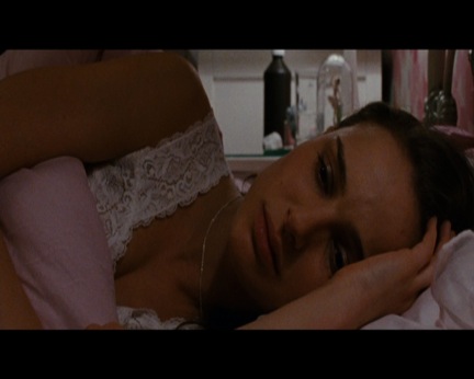

    Image 2 - Window boxing effect (i.e. pillarboxing / letterboxing simultaneously). The original footage was probably 16:9 aspect ratio and converted to 4:3 letterbox (which introduced the black lines along the top and bottom to maintain aspect ratio. This 4:3 letter box has now been displayed on a 16:9 screen which has compensated by adding the pillarboxing along the left and right of the screen resulting in a black border around the video.

    1 - shown as 16/9 on a 4:3 screen, video looks like it should be 2.35/1 creating bigger bars. something circular would help though.
    2- your answer works

    Could you explain in a bit more detail what you mean by your first answer.

    Yes, photo 1 is a 2.35:1 movie letterboxed for display on a 16:9 TV then resized to a 4:3 display.

    photo one could have been created many ways, but it appears it's a 2:35/1 movie being shown incorrectly in 16/9 format in a 4:3 display.

  6. The first photo was probably a 2.35:1 movie letterboxed in a PAL 16:9 DVD frame(720x576, 5:4), then resized to 432x346 (5:4).
