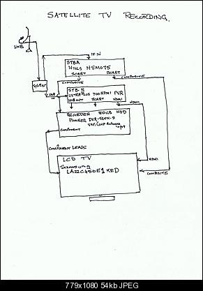

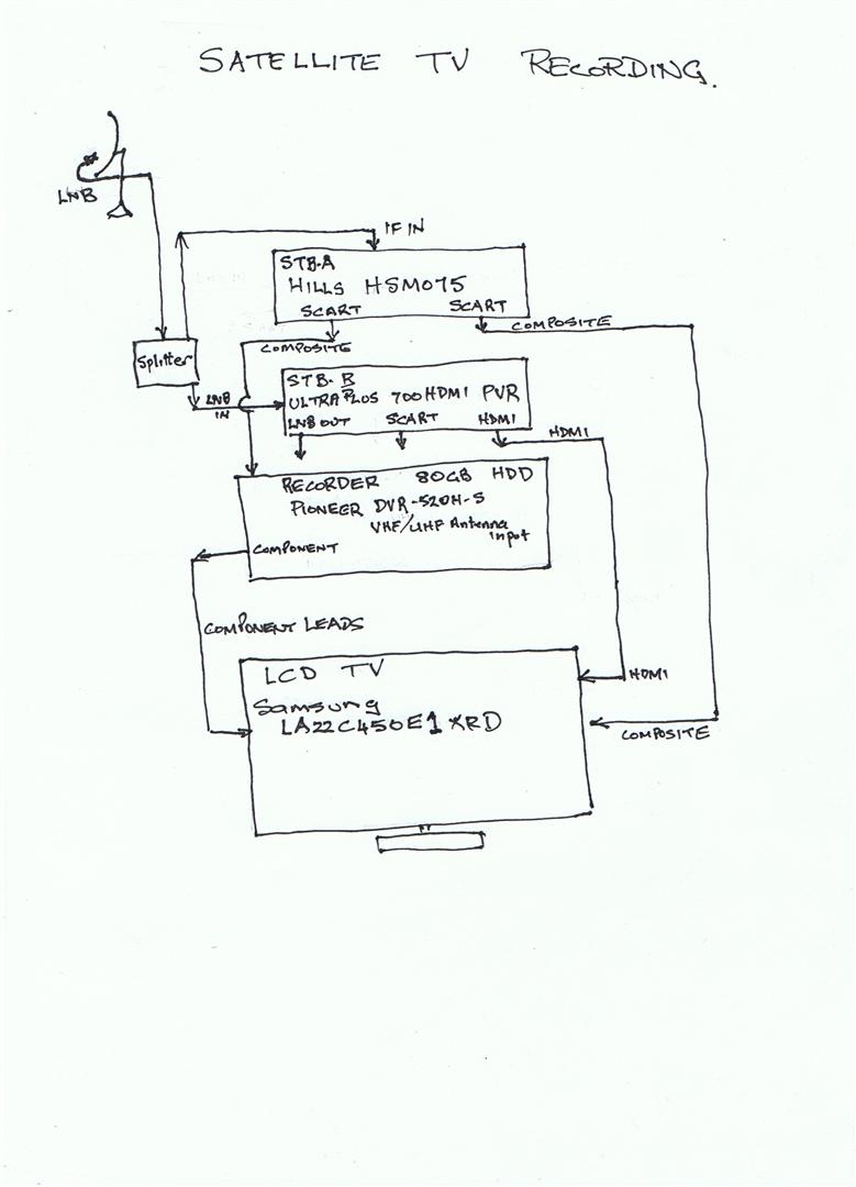

    As you will see from the image below my HDD is the Pioneer;- and the connectors between the UltraPlus (STB-B), the Hills (STB-A), the Pioneer, and the connections to the TV are those that I had available without having to spend any more. My wife won't let me.
    I do have 3 RBG(?) component leads available but no suitable sockets.
    I am viewing Freeview via satellite in New Zealand and am wondering if I should be using the STB-B connected to the Pioneer recorder.
    Does this help to give you an idea of the setup.
    Even though the UltraPlus 700HDMI PVR is directly connected to the TV I don't get Teletext as I should.

  6. Member DB83's Avatar
    Jul 2007
    You picture a satellite dish but do you actually have one or is it just an aerial capable of picking up a digital freeview signal ?
    I would be tempted to try this:
    1. take the splitter away
    2. LNB in to STB-B
    3. IF cable from STB-B('LNB' out if that is an identical connector as the 'LNB' in) in to STB-A(IF in)
    4. Scart from STB-B to the recorder instead of from STB-A

    Hi DB83
    Yes the dish is the method of reception. We don't have terrestrial (VHF/UHF) in our area.
    The IF IN (STB-A) and the LNB IN (STB-B) are F-Type connectors, as is the LNB OUT on the STB-B.
    It would be possible to remove the splitter and connect the aerial direct to the STB-B with the LNB OUT then connected to the STB-A IF IN, but I am unsure as to how this will affect the STB-A functions. I still need to be able to view one channel while recording another. Any suggestions.
    If I purchase a new SCART Component (or S-Video) lead, I could make the STB-B the primary decoder and connect it to the Pioneer recorder instead of the SCART Composite from the STB-A. I would need to add audio leads (?) as well.
    I have been advised that the HDMI connection from the STB-B and the TV is the reason that the Teletext doesn't work as HDMI doesn't support Teletext.
