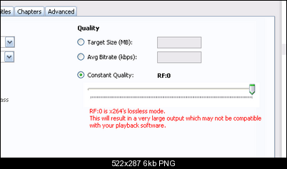

  1. Friends i am useing handbrake to backup/convert my dvd files (vob) to MKV so directly i play it on my LG LEDtv via USB.
    so here i have 2 quarry
    1> Wat settings should i keep (constant quality as by the above pic) RF20 to15 or less then that.... do it really inc the quality as by default its on 20 and i change some time to 15 but i find rarelly any difference in the output.
    and
    2> when useng H.264 do i use 2 pass method...as its take lot of time :/ .. will it effect in the quality and what size it will be as i dont need more then 2gb output
  2. Use 2-pass mode when you need a specific file size (bitrate). Like when you need to fit a 2 hour movie on a 700 MB CD. You will get the best quality for that file size. Use constant quality encoding when you want to be assured of a specific quality and don't care about the file size.
    If you encode a video at constant quality of 20 and it turns out with an average bitrate of 1000 kbps, then go and make a 2-pass encoding at 1000 kbps, the two videos will look nearly identical.
  3. hmm thatz means hardly any diff will come if i used 2pass or constant quality with same bitrate !
