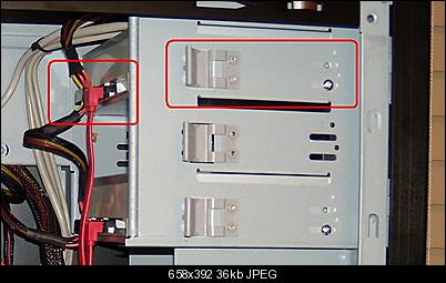

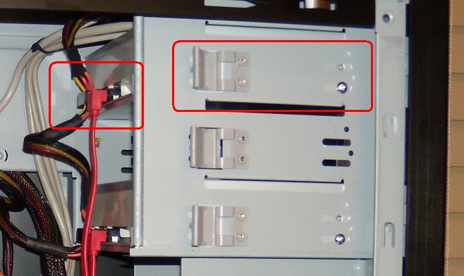

    Here's a photo from a PC. It uses clips and I added a screw to help hold the drive in place. You can also see the power and data connectors at the rear of the drive. With a few PCs, you may have to remove the front panel, but if so, there are clips to the sides of it to release it.
