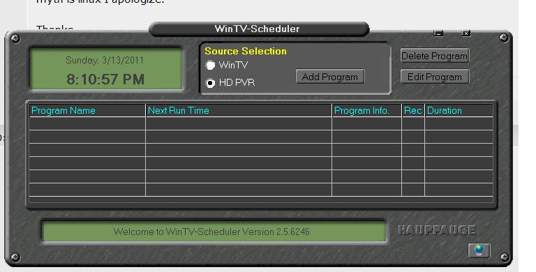

  2. Doesn't the Hauppauge Scheduler work with the HD PVR?
    Holy crap! I never knew this existed!
    [img]wintvscheduler.jpg[/img]
    I thought all the stuff that came with the hdpvr was under the Arcsoft tab in the windows start menu.
    Sweet!
    Thanks jagabo.
    I don't have time to fiddle with this tonight but hopefully tomorrow night I can play around with this.
    Edit - I did look around the program. Where is the accept button when you go to "add program"? Each time I've tried I have to go in and manually shutdown the program through windows task program.

  4. It's been a very long time since I used it. As I recall, you have to leave it running. But I think it minimizes to the Tray. I think there was something tricky about entering events too.
    Actually I found my initial problem - thanks to google.
    Its a dpi issue. I am using my hdtv as my monitor and its set to 120. THe faq page at hauppauge says it needs to be 96.
    At least for the test run I'll settle with the smaller font size. If I like doing this I'll only have to switch back and forth when I want overnight live recordings.
    If this keeps being cumbersome with dpi resets I may end up just keep doing what I'm doing and record then replay for capturing.
