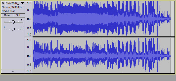

    I have an avi file that has a segment with a high squeal imposed on someone talking. I used VDub to remove the segment to operate on it with Audacity under Win7. I've attached a jpg of the wave, and have played a little with the generators. Just by looking at the wave, I'm not sure what would help. I would think knocking out high frequencies, and using noise removal. That didn't quite do it. Any suggestions? What's the difference in the wave between the light and dark blue of the wave?

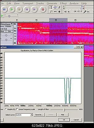

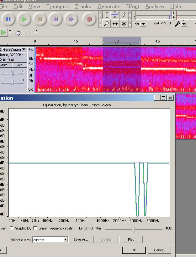

  7. Lowpass at 3K with a 48 dB/octave falloff (the default is only 6 dB/octave).
    The spectrum view is time on the horizontal axis, frequency on the vertical axis, and color represents volume, blue for the lowest volume, through reds, then whites for the loudest frequencies. In the example below I've used the Equalization filter to apply two notches to a short segment of the sound, one at about 4 KHz, the other about 6KHz. You can see the white peaks are gone. And when you listen to the segment the squeal is much attenuated.
    You can also mark a small section and use Analyze -> Plot Spectrum to see where the peaks are.

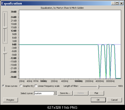

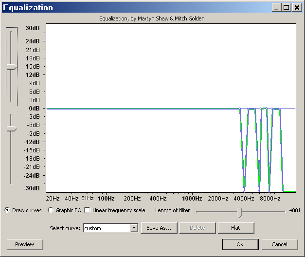

  10. A short segment, before and after:
    Remember you have to adjust the notches as the frequency of the noise changes.

    This is all well and good, but I don't have the slightest idea how to make a notch filter. I puttered around with equalization and found no way to "draw" a curve. All that moved was the horiz line.
  12. Each time you left click on the blue line it makes a new node. You can then drag the node around by left clicking on it.
    By the way, enabling the Linear Frequency Scale option will make it easier to draw the curves in the high frequencies.
