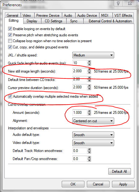

    The only effect you can automatically apply across all clips easily is a simple cross fade. The following is from the Preferences dialogue in Vegas Pro 8
Name:	Vegas Auto Xfade.PNG
    It will set the duration of still images to 2 seconds each, and if loaded as a group, will put them on a timeline with a 1 second cross fade between each image.
    I don't know of any way to apply this type of effect across a timeline that already has images on it, other than through writing a custom script.

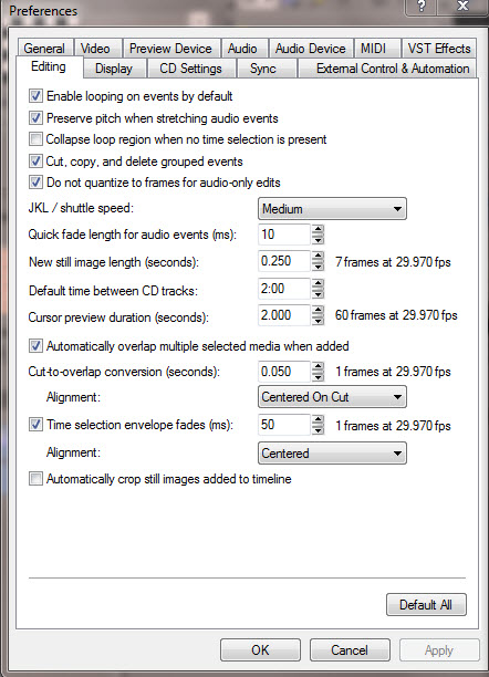

  4. Member solarblast's Avatar
    Nov 2004
    N. California. USA
    It looks like I need to putter with the values in the Pref->Editor. We do seem to have different versions of Vegas. Mine is 9.0. See attached. (I might have added two that are the same. I can't see what is attached.) It seems that my duration is so small, 0.25, that there's little chance to see a dissolve.
    I'll take a look at the avi files.
