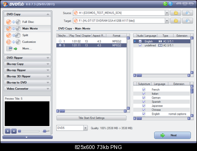

  6. this is so weird; I'm gonna try to explain the problem in more detail:
    below is the source dvd9. It contains two episodes, and as you can observe, they are both included in the same VTS:

    and this is the episode that I ripped. It has a duration of 01:01:11

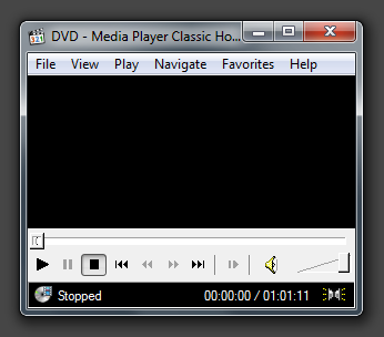

    ... and this is it's duration:
    and it's audio is perfectly synchronized

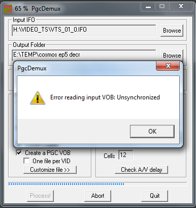

  11. Click image for larger version
    how is this possible ?
  12. Did you already run the DVD through FixVTS? That's a problem, alright, but not one caused by 'strange DVD structure', and not something you mentioned earlier as what was strange about it.
    You were saying what was strange about it that it had 2 episodes in the same VTS, which isn't strange at all. You didn't even tell us if there were 2 titles in that VTS, each corresponding to an episode, or if both episodes were part of the same title.
    Episodic DVDs don't generally have advanced copy protection. Did you try DVD Decrypter already to decrypt it, perhaps followed by running the VOBs through FixVTS. Even better is to use RipIt4Me which uses both DVD Decrypter and FixVTS.
