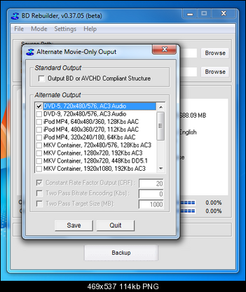

  7. Yes it does. Under "Mode" select "alternate movie-only output". Select that. Only the movie will be done.

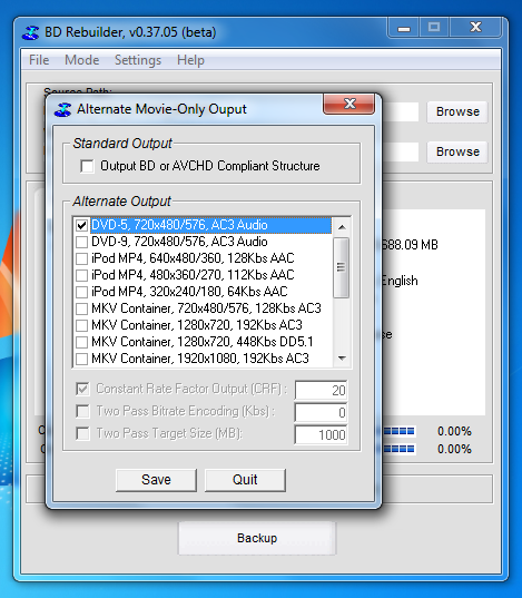

  8. Hmmm. Alternate Movie Only Output is greyed out for me.
    Oops.. I needed to select Movie Only Backup first, then the other option became available.
    I'm going to try it right now.
    Thanks.
  9. Worked great. I am impressed with the results.
