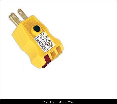

    I think one of the power outlets is wired backwards.
    http://www.amazon.com/Electrical-Receptacle-Outlet-Ground-Tester/dp/B0012DHVQ0/
    You can buy these things locally, I got mine at Radio Shack
