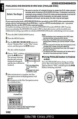

    make sure the power cable is attached to the cam and finalize the dvd. from the manual.
