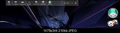

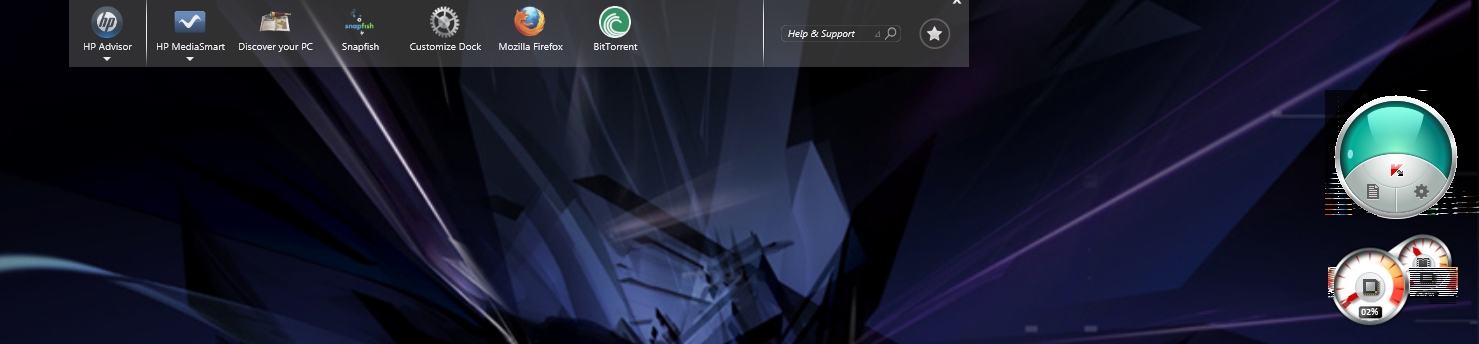

  1. Hi guys I got a computer at christmas fairly new and in the past 5days it's making a loud buzzing noise so I chatted with HP support and said see how it goes then call back I even opened the case and tried to isolate the problem I don't think it's the hard drive it was coming from the power supply, graphics card etc.... but now my desktop gadgets are going bezerk and I think it's the graphics card I'll post two images then i'll log off and give it a rest. Share your thoughts and help is appreciated .Click image for larger version

  2. That really does look like a graphical issue. Try booting from a linux live CD and using it for a while. If it does the same thing then it's likely a hardware problem.
  3. The buzzing may be the fan on the graphics card. It's failing and the graphics chips are over heating.
