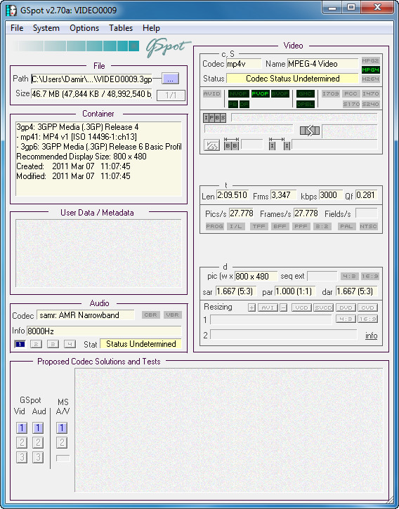

  1. .. multiple video files recorded with htc desire (mpeg-4) after joining with various video joiner tools on pc (simple avi or mpeg2) gives wrong/faster frame rate then original file, but when change frame rate in video joiner options - it gives same result .. is there a way to fix that? ..
    thanks!

    I have some similar video clips(3GPP Media Release 5), made with my mobile phone.. that are reported as 24.390 fps by g-spot, and reported by mediainfo..
    Frame rate mode : Variable
    Frame rate : 29.366 fps
    Minimum frame rate : 9.615 fps
    Maximum frame rate : 250.000 fps
    And i got the best(closest to real) audio/video synchronization with avisynth using:
    DirectShowSource("D:\video.MP4", fps=29.352 , convertfps=true)
    I didnt had enough time to look for better way.
