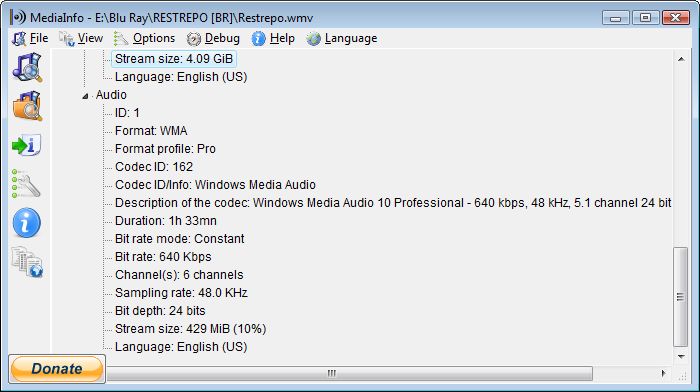

    I have attached two MediaInfo screen shots, one with Menu, and one that is missing the Menu tab, so you can see what I'm talkingabout.

    Here is a screen shot of the top portion that is missing. I couldn't get all of it to fit on the screen, but you can reference the audio portion to the previous 'No Menu Picture'.
    If WMV is not suppose to have the menu tab I wonder why it is on everyone of my hd wmv's, well except for these few odd ones that don't play audio?
    Should be noted that I use AC3filter, and it works great for playing surround sound through my amp using wmp and wmc. Of course with these few odd wmv's, AC3filter does not load like it's suppose to, so hence no audio. When I play these files in vlc media player it plays, but of course only in stereo since it doesn't depend on AC3filter.
