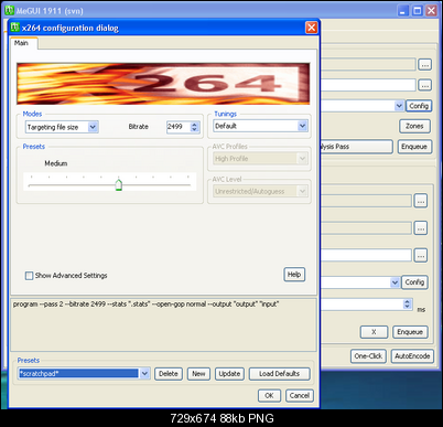

    Here is a pic of my .H264 configuration page within MeGUI (latest version, auto updated)

  6. Actually the question was with respect to SD was in regards to decoding. HD content is almost exponentially slower to deinterlace using QTGMC (maybe this was HDTV cap of survivor?) . If it's DVD rip, then it's SD
    Those specs don't tell me anything. If you have an older single core CPU, then it might take that long. If you have a fairly recent quadcore you should be getting a lot faster
    You can try using a faster preset for QTGMC, e.g. preset="faster" or "very fast". It will still be better than Tomsmocomp, but some shimmer may start to creep in. Note "very fast" is still glacially slow compared to tomsmocomp or yadif. Have a look at the documentation for more details. You'll have to decide where you want to make trade offs. You can use AvsPmod to preview single frames in different script versions in different tabs and swap with the number keys, although you may want to do some small test encodes, because motion is important to assess for deinterlacers
    When doing 2pass encodes with heavy filters, many people use lossless intermediates (e.g. huffyuv, ut video codec). This way the slow filters are endured only once instead of twice. The overall time is can actually be faster
    If you don't need a set file size, you can use CRF encoding (or quality based encoding). This is faster (1 pass) and it allocates the appropriate bitrate for the quality you set.
