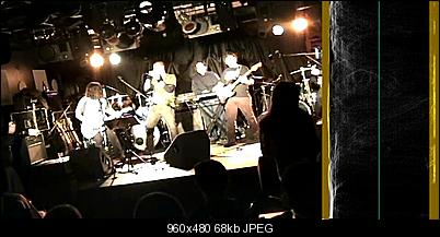

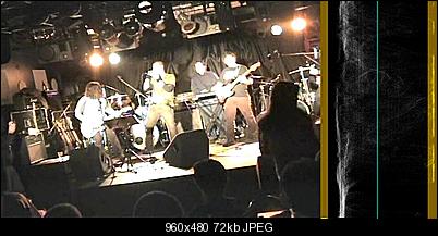

  6. Horizontal edges are much sharper now that you're no longer zooming. But the levels are still off:
    You want to keep the levels out of the brown/yellow areas. There's no reason to use both Tweak() and ColorYUV() to adjust levels. I would adjust levels before denoising. If you want to bring out more detail in the dark areas use a gamma adjustment.

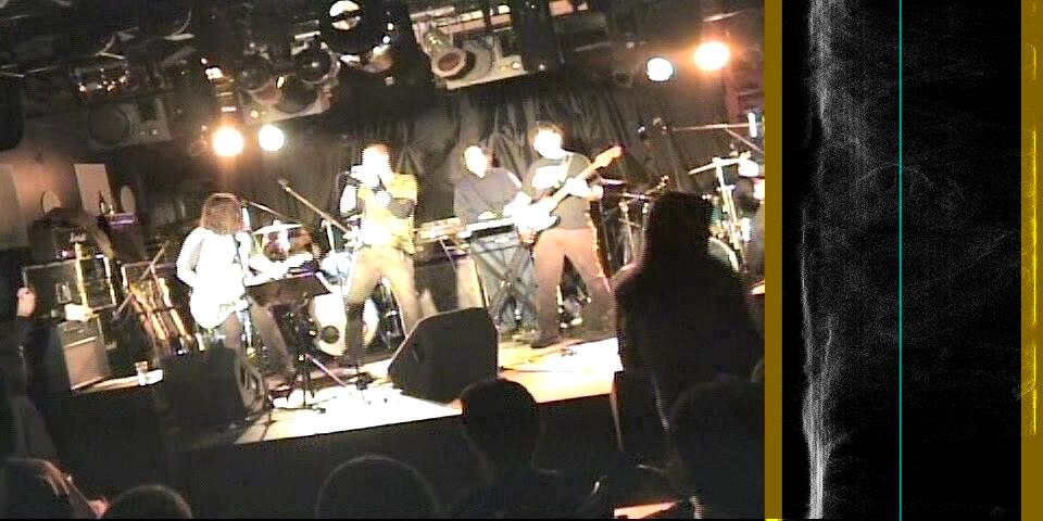

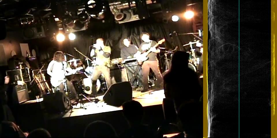

  18. Your brights are still too bright and your darks aren't dark enough. Are you even bothering to look at your results?

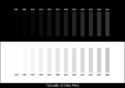

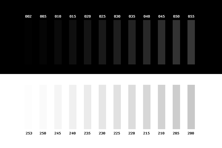

  20. You can check your monitor with a calibration image. Try the following:
    You should be able to see almost every bar. I can barely see the 5 bar, and have to use my imagination to see the 2 bar. But I can see all the others. The background should be full black in the top half, full white in the bottom half.
    After adjusting your monitor and Desktop you need to adjust your graphics card's video proc amp using a video calibration chart. This post:
    https://forum.videohelp.com/threads/326496-file-in-Virtualdub-has-strange-colors-when-o...=1#post2022085
    has a similar calibration chart as a DV AVI file. But there is a slight difference. The bars from 15 to 0 should all be black, and the bars from 235 to 255 should all be the same shade of white.
