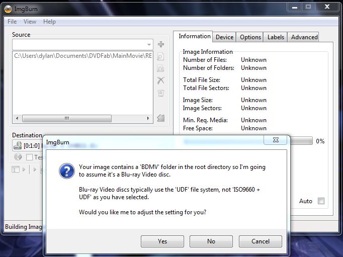

  9. Use a BD-R/RE, select whole folder or BDMV+Certificate then imgurn should ask the following and select yes or change the filesystem manually to UDFv2.50:

    PS What you describe is exactly what I did.
