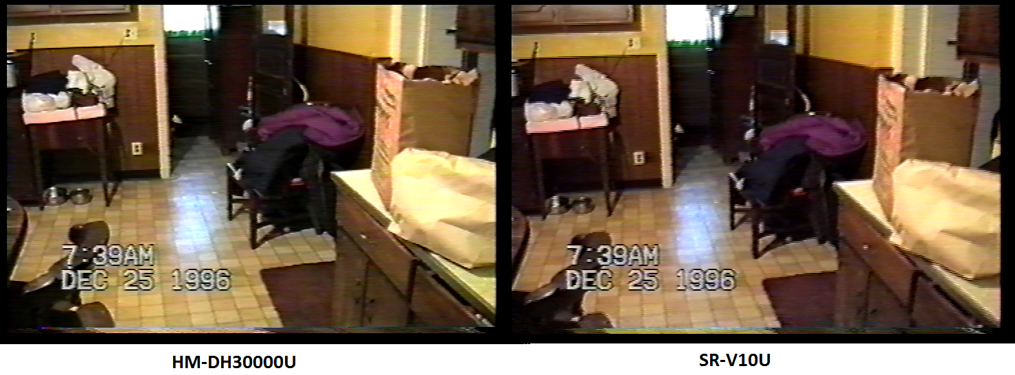

    Here's a screenshot with one of my old family videos that has pretty bad time base errors. Both VCR's had TBC/DNR on, EDIT picture mode, and all other features (Stabilizer, R3, etc) turned OFF.
    Also ran an EP tape that has had tracking issues with some VCR's through the 30000U. Played/tracked just fine.
    Bottom line--advantage of getting a 30000U if you already have your 7800 is probably minimal.
    The picture even looks a bit noisier from the 30000 in the above screenshot, although I have to say that's not always the case. I might not have gotten the exact same frame when I paused the video to get the screenshots?
