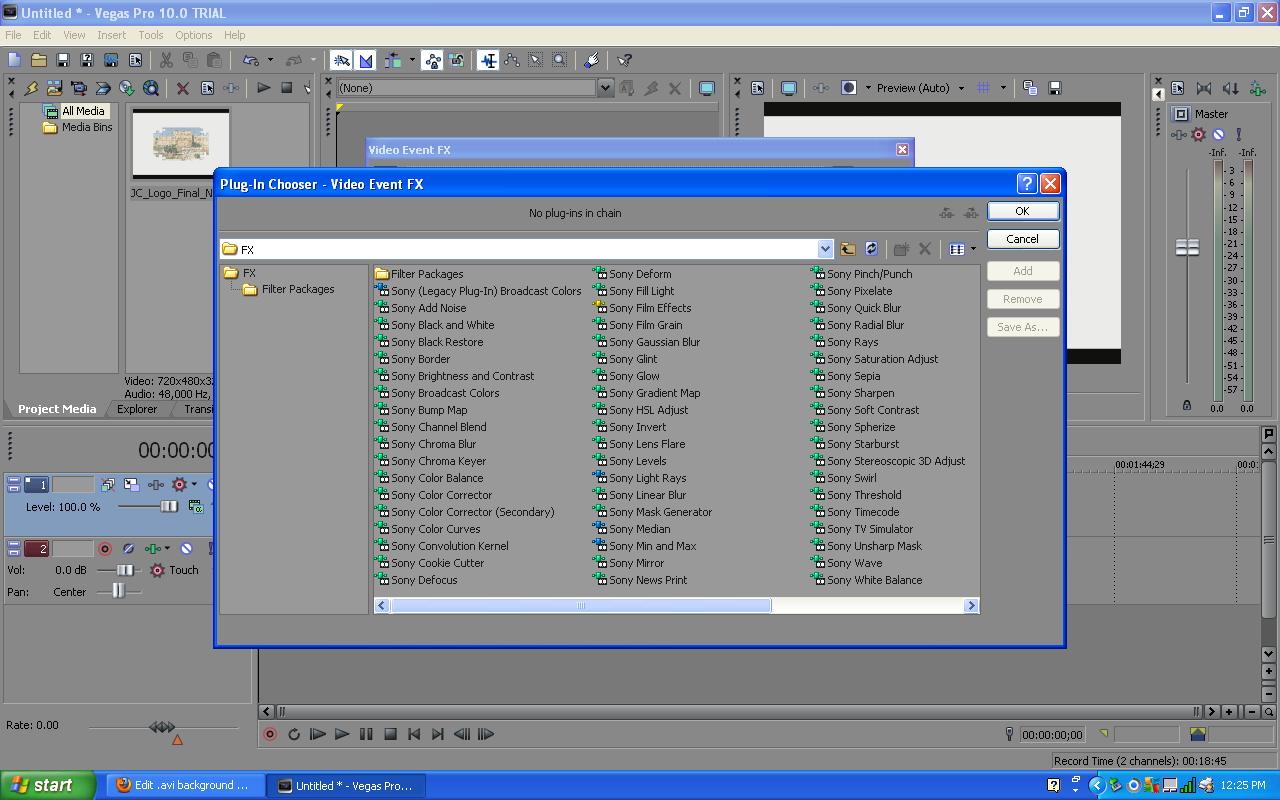

    Ok, I downloaded Quick AVI Splitter which can split up a video by frame, but I learned that's not a feasible option, seeing as the video has 600+ frames. It would take forever to modify each individual frame by hand.
    So, I went ahead and download Vegas Pro 10.0 like you suggested, and took a look at the program, but could not find an option to insert a "green screen" effect, as you put it. Vegas Pro has many Video Event Fx options, but "green screen" was not one of them. I attached a screenshot of the effects that are available in the program. Maybe you'll be able to spot the one that I need.
    Thanks.
    EDIT: And like already mentioned, the background color is the exact same for all frames, and I wish to change it for all of them.
  4. it's called "chroma keyer" in vegas , but if you key it out, it becomes transparent , so you have to put a layer underneath to "show through"
    another method is "secondary color correction" . e.g. change someone's shirt color from red to blue . Search google and youtube - there are dozens of step by step video tutorials on how to do this
  5. Originally Posted by poisondeathray View Post
    And how do you put a layer underneath?
    Thanks for the reply.
  6. you can use anything, just drag it to the track below
    e.g. a png from photoshop . Or you can use vegas' media generator
  7. Originally Posted by poisondeathray View Post
    Well, I tried that already, but the image obscured the video beneath it for the time that it was visible.
    Should I import the image first, drag it to the timeline, and then import the video?
    Yeah, I think that's what I'll try.
    EDIT: Ok, that appears to work, but I'm confused with the chroma keyer effect. When I select it, it opens a Video Event Fx dialog box with a Preset: drop down menu which has the options "Blue Screen", "Green Screen", "Pure Red Screen", "Pure Green Screen", "Pure Blue Screen", and then it has a color selection tool underneath it. It doesn't appear to be transparent, and when I click the "Animate" button, leaving everything at the default setting ("Blue Screen"), and click Play for the video, it now shows most of the video obscured and invisible, even though I have the image with the new color background underneath the video.
    EDIT: Ok, nevermind. I figured it out. I modified the color of the Chroma Keyer to match the one I want to replace, and it works now.

    wrong relationship
    video on top , color image on bottom
    think of the alpha channel as a see through "hole" so the image below can be seen to "poke through"
    You can re-arrange the order of the tracks after they are laid out, it doesn't matter
