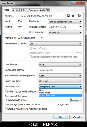

  25. Member edDV's Avatar
    Mar 2004
    Northern California, USA
    If your source is progressive 23.976 fps , here are the basic project settings. Pay particular attention to "Deinterlace Method" in case interlace or telecined source clips are added. "None" will get you split lines, "Blend" gets ghosting during motion. Use "Interpolate fields".

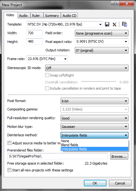

  29. OK edDV, looked at project settings and render settings again, and set it up as picture above, I have uploaded a v small clip that was ghosted to me, and it now looks OK I think, although I'm so paranoid about the damn thing I wonder if someone could just have a quick look and see if quality is ok. It's the same clip played twice from the two sources. Also, are my render settings here ok for youtube uploads?
    video: http://www.sendspace.com/file/crh1l4
    render settings:
    http://img15.imageshack.us/i/renderscreen.jpg/
    Many thanks
