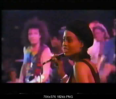

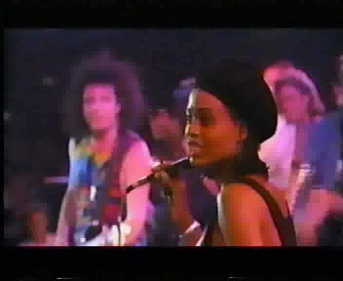

  9. You can deblock it by turning on Xvid's Deblocking option. What you'll get is a fuzzy video instead of a blocky video.
    Not deblocked:
    Deblocked, deringed, film effect:
    That won't fix the comb artifacts. You can use Blur(0, 1.0) in AviSynth for that. Or the Deinterlace (blend) filter in VirtualDub.
