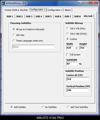

  1. I need to make a srt file but I don`t want to add the subtitle in the bottom center , but on the top center of the video file. How can I do that ?
    Thank you
    srt does not contain any such info. You adjust the position in the player/subtitle decoder.
    If you want it in the subtitle file you must use another format like ssa/ass or image subtitles.
  3. It depends on the player. Some players support non-standard .srt tags or other addons. If your player supports idx/sub subtitle display the easiest may be to use AviAddXSubs to create idx/sub files. Not all players honor the border thickness settings but most will use the position info. It gives a nine position grid. Make sure to put the same info in both Configuration 1 Sub1 Tab and the idx/sub Tab .. resolution position etc..
    I usually center mine 12 to 30 pixels from bottom center. To center at the top divide the horizontal res by 2 and experiment with the vertical position setting to get it where you want it. The screen shot shows idx/sub settings for an .avi with 624x352 res. Note that if your player then upconverts to HD then stuff like subtitle fonts are going to look much bigger.
