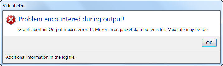

    I opened the .m2ts file in VideReDo, cut one small part out of it and tried to Save it but got this error:
  6. is that the beta version? the compression is avc, so the normal videoredo won't work (it's not 100% working anyway, that's why it's still in beta)
    if you cut at I-frames you can use tssniper, h264_ts cutter, or tsmuxer . GOP length is usually 1 second for hollywood blu-ray (so every 24 frames), so cuts won't be perfect (within 1 second), but there will be no quality loss

  8. Videoredo beta is still buggy and only works some of the time for AVC . You can try getting rid of some of the streams with tsmuxer and try again -it might be all the audio tracks giving videoredo grief (i.e. remux into a new .m2ts with only video and main audio)

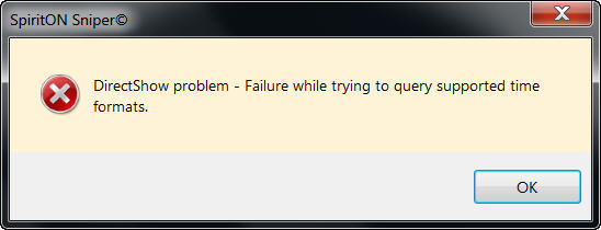

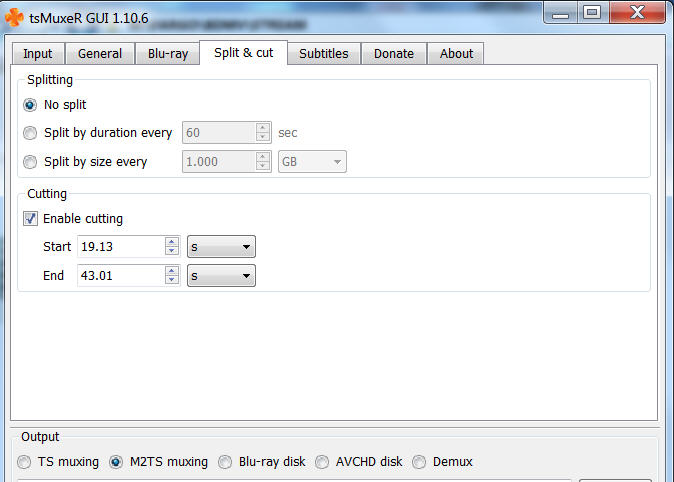

    H264TS_Cutter errors and TSSniper errors are attached, however I think tsMuxeR may work.
    The thing is, on the attached tsMuxeR picture, I wish to cut out the part I chose, but tsMuxer keeps that part and cuts everything else. How do I do the reverse, keep everything except for the part b/w 19 and 43 seconds of the .m2ts file?

  10. for tssniper and h264ts_cutter you need your directshow subsystem working properly. Install haali media splitter and ffdshow. On win7 you also need to use preferred filter tweaker
    for tsmuxer you can try cutting the beginning and end , then join them (use "join" button)

    Oh, I see, thanks for that. I feel that tsMuxeR is the easiest to use as it requires nothing additional to be installed.
    1. If I start tsMuxeR, and simply do what you said (cut twice, join once) - will the final file be identical to the original except for the cut 24 seconds, in other words, do I need to go into any other setting of tsMuxeR to make sure it doesn't change or insert anything else, so that it just takes the .m2ts file as pictured above and cuts out one part w/o making any other changes whatsoever, then joins the two cut parts back together?
    2. What do you use to determine or preview which hour/minute/second of the file is cut out with tsMuxeR?
    3. Can you just put the end at 100000 min so you don't have to figure out the exact length of the .m2ts file if you wish the end to be the actual end of the file?

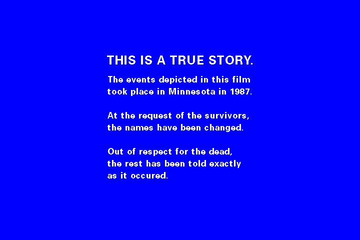

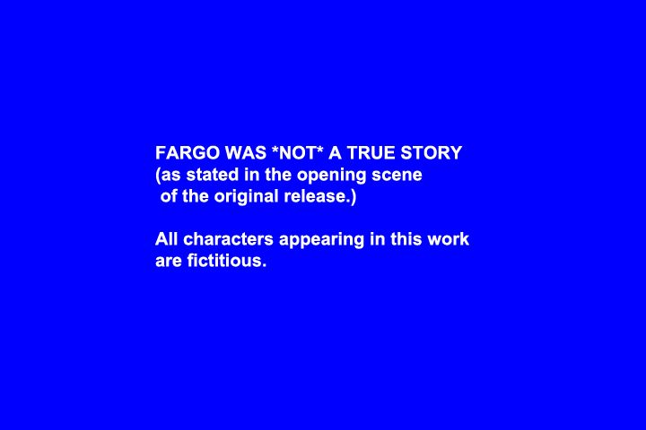

    As for the other topic, I was only going to overlay a single picture over the existing video and audio inside Sony Vegas.
    It would cover only parts of the existing video for 24 seconds. I was hoping that would make things easier?
    By the way I wish to overlay the equivalent of this standard DVD picture over the other, that's what this is about:
