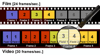

    It is the weekend; I don't have much time, but I'm determined to try and make you understand about film-to-video transfers utilizing telecine film system with 5-bladed shutter. Have a look at this nice diagram:
    Notice that Video Frame 4 is made from the BLENDING of Film Frames 3 and 4. This is what I've been trying to explain.

  10. Originally Posted by filmboss80 View Post
    [Attachment 5901 - Click to enlarge]
    That is nothing more than standard hard telecine with 2:3 pulldown. Nothing is blended, the two fields (3.1 and 4.2) are simply woven. Normal telecine like that judders on playback on 60 Hz devices, interlaced and progressive.

  15. Originally Posted by filmboss80 View Post
    I had intended to assert that the aforementioned film-to-video method in no way produced the kind of judder seen in the 24v30v60.avi clip in https://forum.videohelp.com/threads/307004-Best-framerate-conversion-%28eg-23-97-to-30-...=1#post1888926 .
    Burn that video as a 30i DVD. If you do it properly you'll see the same 3:2 pulldown pattern on the top row of circles if you look at individual frames. And it will judder just as much on a TV as the original does on the computer. Yes, I used worst case test pattern to make the problem obvious. But once it's pointed out to them, even the average viewer can see it in "normal" video too. Certainly 2bDecided was seeing it.
    Software can produce hard telecine 3:2 pulldown from 24p sources exactly like a five blade projector.

  24. 24p is often encoded by cameras as 30i after 3:2 pulldown. You have to inverse telecine to get back to 24 frames.
    This is exactly correct.
    I follow you so far; I can see your point by doing the inverse telecine, that it will obtain a better picture in the long run and less motion blur which I did notice in some of the videos I created.
    I tried using the "decomb" filter in AVISynth to do the inverse telecine, and it reduced the fps back to 24, then I used "AssumeFPS" to slow it down to 18 fps and the sound is right on so it seems to be at the correct rate as it was originally filmed. The results are actually quite good, and in fact seems smoother than the original way I was doing it. The AVISynth script I'm using is:
