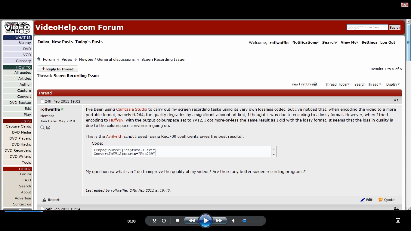

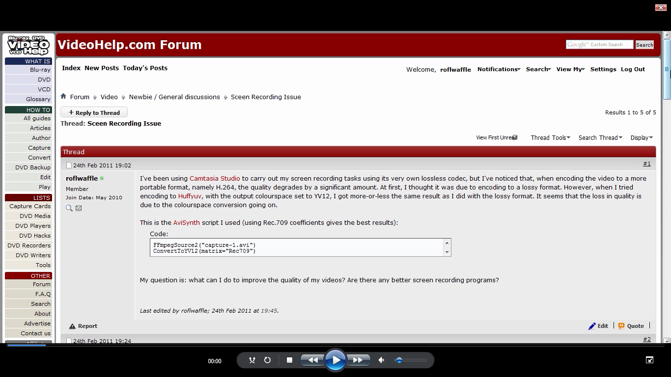

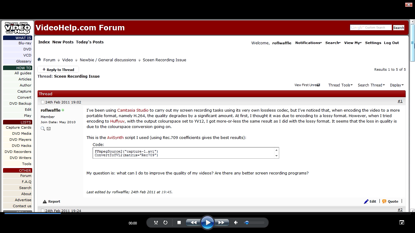

  6. Original:
    https://forum.videohelp.com/images/imgfiles/yYlq7.png
    Rec709:
    https://forum.videohelp.com/images/imgfiles/TPwBC.png
    PC.709:
    https://forum.videohelp.com/images/imgfiles/XIR53.png
    Rec.601:
    https://forum.videohelp.com/images/imgfiles/LAfMM.png
    PC.601:
    https://forum.videohelp.com/images/imgfiles/JFCOF.png
    I've seen worse than this, but I can't reproduce the example. It was from a presentation. The colours would basically "glare" out with some bright text.

  7. In that example, the chroma is slightly shifted there (color edges aren't as crisp). You can use chromashiftsp using a subpixel shift (like 0.5) to make it "in line" . There is actually a patch to improve the shift in newer versions of 2.6 (not released yet), but if you're interested I can give you the more information

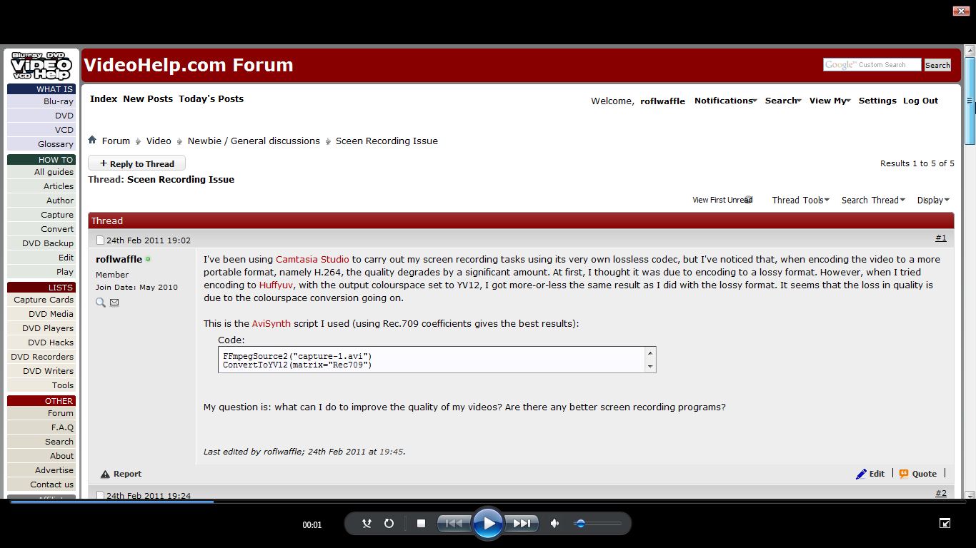

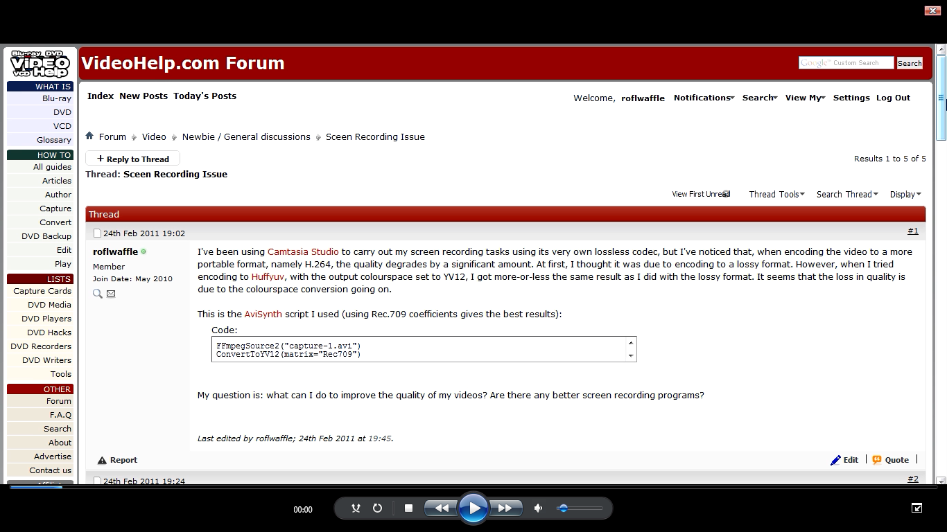

  8. I tried to reproduce it.
    Original:
    Rec709:
    PC.601:
    This is what I meant by it glaring out.
    Edit: Now that I look closer at the "VideoHelp.com Forum" header from the previous examples, it is happening to that as well.

  9. Yes that's from subsampled chroma . There is much less color information in YV12 4:2:0 (every 4 pixel of luma has only 1 of Cb and Cr) . There is no perfect way to keep all that information, unless you stay in RGB . It's especially evident in that example, because everything is an "edge", so you get blurring everywhere

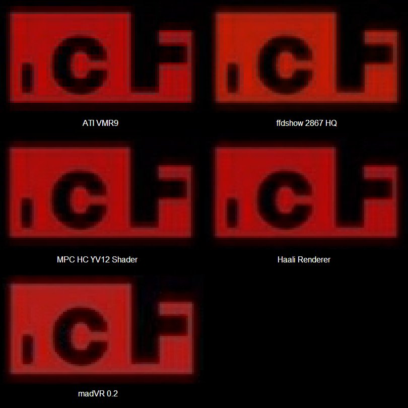

    The method in which you view it also makes a difference. If that player or screenshot method uses high or low quality upsampling methods, or if they use a 709 or 601 matrix (the YV12 encoded material has to be converted back to RGB for display)
    The choice of renderer for display also makes a difference. For example, madvr
    https://www.videohelp.com/toolsimages/madvr_1196.jpg
    None of this will help much. And they all have pros & cons - the ONLY way to preserve the quality is to stay in RGB. There is just too much color information missing for YV12
