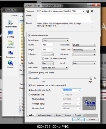

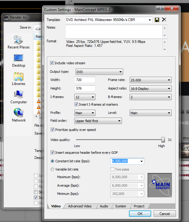

    From an HDV-PAL project I would export encode this way. Note the change from VBR default to 9500 Kb/s CBR. Max duration at this bit rate is about 1 hour. DVD Architect will import this asset with no recode.

  11. SO i should try this way.I dont think that i had those settings in my previous effort with Architect.
    Could you think of a reason why i had such differnce in quality from the pc to the dvd player?

    Yes. These settings should max the quality using Vegas to downscale.
    Don't forget to save the HD version as well. If you want to save to 1920x1080i/25, increase the MPeg2 bit rate to 35 Mb/s CBR.
