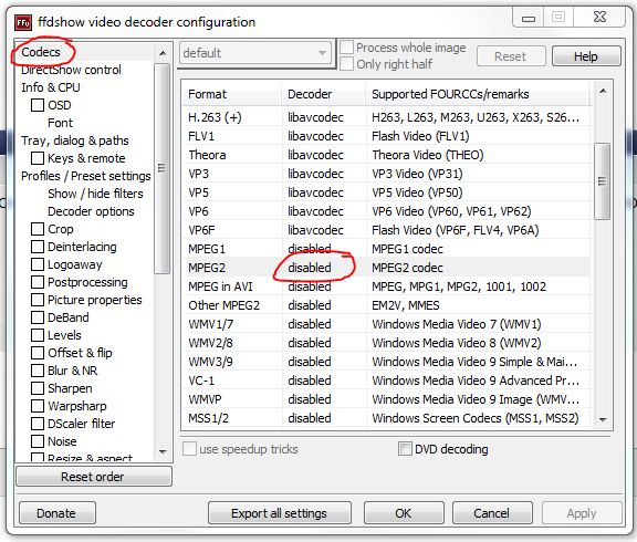

  1. I AM HAVING A PROBLEM BECAUSE MPEG 2 IS DISABLED IN FFDSHOW. I CANNOT FIGURE OUT HOW TO GET IT ENABLED. THERE DOES NOT APPEAR TO BE ANY BUTTONS OR CHECK BOXES, ETC. IF ANYONE CAN TELL ME HOW I WOULD APPRECIATE IT.
    THANK YOU.

    Open the Video Decoder Configuration utility (Found under FFDShow in your Start menu). Find Mpeg-2 in the list of codecs, then click where it says "disabled" and you can then choose a decoder from the list.

    I do not know which codecs I should choose. I am using ffdshow with 'Rebuilder' to make a backup of a new BR disc.
    Thank you for the help. Especially the screen shot which made it easy to understand.

  6. I have tried but not been able to reset the MPEG 2 correctly. I do not know how to fix VC-1.

  7. FFDSHOW configuration:
    1) Reset VC-1 to WMV9
    2) Reset MPEG2 to libmpeg2
    3) Run inspect.exe again
    Pull! Bang! Darn!
  8. I cannot get V=1 to reset to anything but disabled. I have tried right clicking, left clicking etc. Could you help me with the steps? I was able to get MPEG2 reset to your suggestion.
    Thanks for the help!

  11. I do not get any drop down choices except "disable". I am running Win 7 Home Premium with SP 1 installed. I have the version of ffdshow from the link on BDRB website, which warns of newer version problems. However based on what you suggest I am going to try a newer version. Thanks for keeping the dialogue with me. I appreciate the help.
  12. I suspect the problem isn't the version, but rather a corrupted install. I'd first try uninstalling ffdshow, run a registry cleaner (like CCleaner), reboot, then re-install the recommended version again.

  15. I would get rid of the codec pack, delete the program folder for it and run a registry cleaner. Your runtime error is either a stuffed helper program, probably haali, or a recurring bug in BDRB that affects a small number of users. I suspect because their machines are not entirely stable.
    After removing all traces of the codec pack, uninstall ffdshow, haali, and avisynth. Manually delete the program folders. This is particularly important with haali, as it is prone to getting corrupted and an uninstall can leave behind junk which screws the re-install. Reboot, run a registry cleaner like CCleaner, and re-install recommended versions. Recommended versions, mind you, don't fool around.
    Delete your BDRB folder as well. Download and unzip version 0.37.04. First right click on REG_MSCOMCTL and Run as Administrator. Then right click on BD_Rebuilder.exe and run as Administrator. This allows BDRB to configure itself correctly in WIN7, according to what I've read. (I'm on XP).
    Then run inspect.exe again. If everything checks out, try another encode.

  18. Do to work pressures it took me until today to get back to my BDRB project. I did everything you suggested except I kept the same copy of BDRB, V 3705. I ran the inspect utility and it said OK to everything. I then proceeded with the program setting the result to an ISO file. Everything ran like a charm. At the end I tried writing the ISO to a disk with BDRB. It did not work. Nothing was written to the disk. I then used Image burn to write the image to the same disk and bingo, it wrote without a hitch. I watched the entire disk to see if there were any problems. It is a perfect copy with all the extras working.
    Thank you for all your help! I am looking forward to backing up other disks. Then I will be able to relax when the kids watch any of my DVDs.
