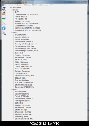

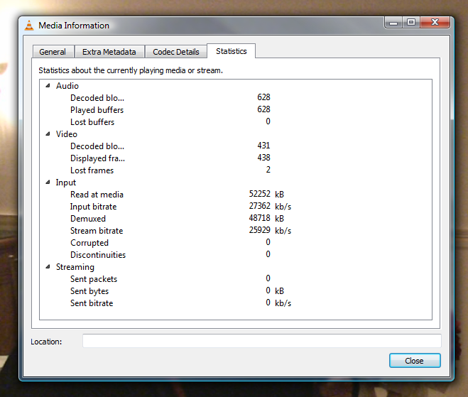

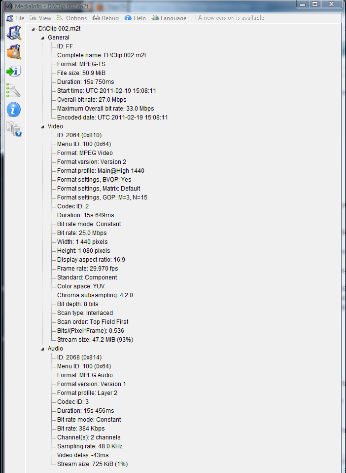

    The file specs look correct. I can't explain the pixel drops. If you aren't seeing these drops when the tape is played to a TV, something is wrong with the IEEE-1394 connection. Try a different computer and a different cable.
    VLC reports two dropped frames in addition to the pixel loss.

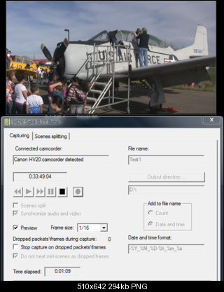

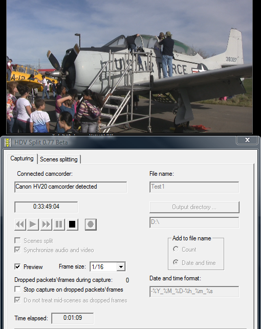

    Here is what HDVSplit looks like on mine with a 1/16th size preview. Preview should be turned off if you are having problems.

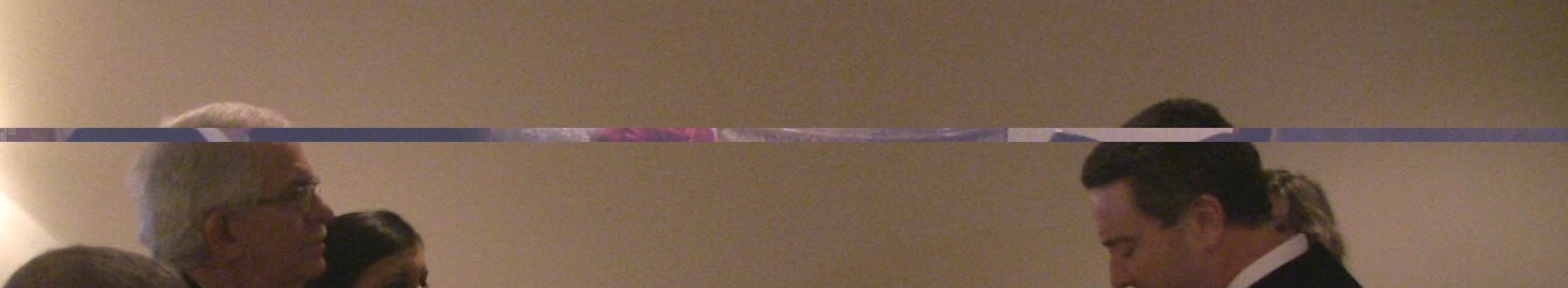

    bizarre. the files on the computer are 1 to 1 bit digital transfer copies of what's on the tape.
    were the tapes new or had they been used before?
    there seems to be some bleed through from a previous video?
    [Attachment 5737 - Click to enlarge]
    But if the drops were tape related, he would see them in a direct playback to an HDTV. Plus he is getting the drops from a live camera feed.

    yeah it's weird. but that line of video in the middle of the picture i posted is definitely not at all related to the main video or any frame anywhere near it.
