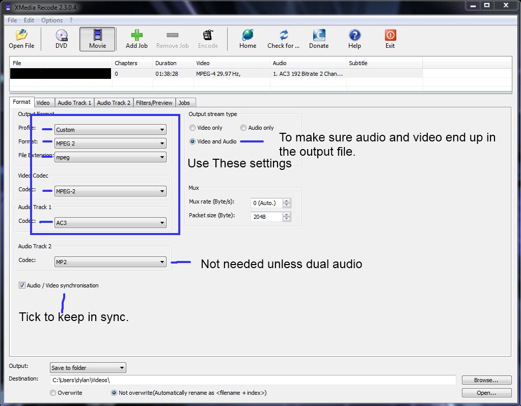

  3. Make sure Video and audio Output option is selected and specify ac3 or mp3 audio, The first page is what you want your output formats to be.
    Sir,
    Referring to the attached picture, the setting for the "Format" was MPEG-2.
    I'm a newbie so please permit me to ask the following questions:
    Can I use the MPEG-2 encoding for a VCD?
    Or should I the MPEG-1 format instead, for VCD?
    Thank you !

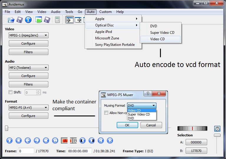

  12. Yes you are right, I thought you said output was gonna be mpeg so I figured no-one creates vcd anymore as it's an outddated format but i'm apparently wrong.
    How it is: mpeg1 for vcd and mpeg2 for dvd. You can also use avidemux for mpeg1 creation as shown below:
