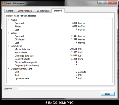

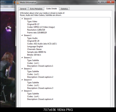

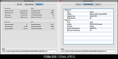

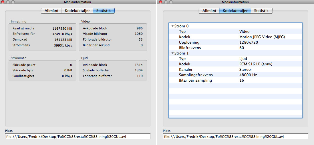

  6. Click image for larger version
    Duration is just over an hour.
    Oh, and sorry about the Swedish VLC. :P
  7. Member edDV's Avatar
    Mar 2004
    Northern California, USA
    OK, you have 1280x720p Motion JPeg (MJPEG) at 60 fps with ~60 Mb/s bit rate.
    Audio is 16 bit, 48 Kb/s uncompressed PCM which should play in VLC.
    MJPEG is not supported by FCP directly. Try converting to AIC or ProRes422.
