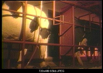

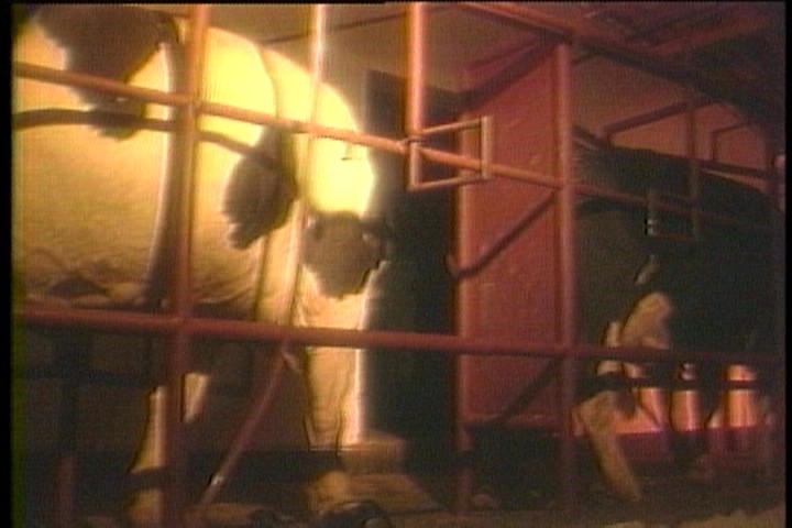

    I wonder why this topic stopped in black or color adjustments, when I said what I wanted more to correct are those "fading repeated vertical lines" (I don't know how that is called) to the left of most vertical objects.
    How can I improve on that?
  6. Those are ringing artifacts from a sharpening filter. Try disabling any sharpening in the tape player. But it appears you have several tape-to-tape generations of this so simply fixing the last one won't help much.
    A few Blur(1.0, 0) filters in AviSynth removes most of it but blurs the image a bit too.
    Before:
    After:
