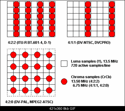

    As far as I can tell, Firewire transfer in live mode is still HDV. Otherwise the captured file would be larger. I haven't measured the analog component PbPr chroma vertical bandwidth. Horizontally, 4:2:2 and 4:2:0 are similar.
    It may be possible to get 4:2:2 chroma with analog component capture at the cost of D/A, A/D luminance loss.

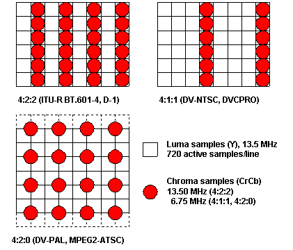

    http://www.dvcentral.org/images/Image1.gif
    Keep in mind that DVD, Blu-Ray, ATSC and DVB are all 4:2:0. So is the Apple Intermediate Codec (AIC).
