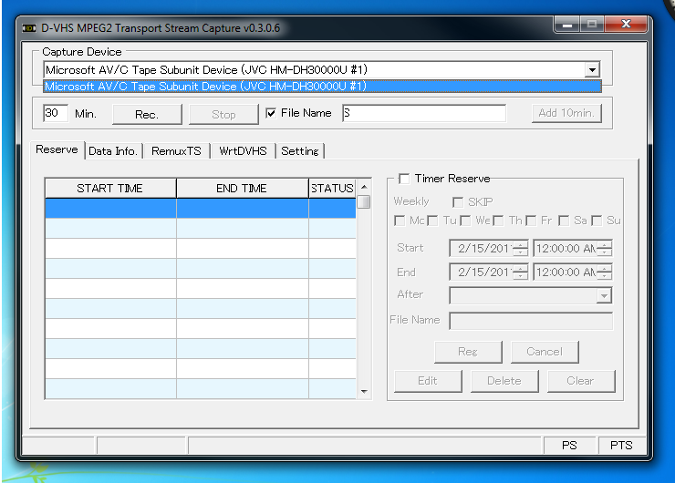

    I'm a hands-on guy... so after that last post I took the top cover off of the unit. What did I find??? Well... look at the photo (sorry it's a Blackberry picture, my digital camera batt is dead). It's a FIREWIRE PORT!
    And wait... what does it show up as when I plug that firewire into my PC? Look at the second photo.... an HM-DH30000U!
    I was able to capture analog input to the A/V ports just like on the HM-DH30000U I tested. Unfortunately, also like the 30000U, I wasn't able to capture a VHS tape being played directly on the unit, only signals fed to the analog inputs.
    So it IS a 30000U in disguise!
