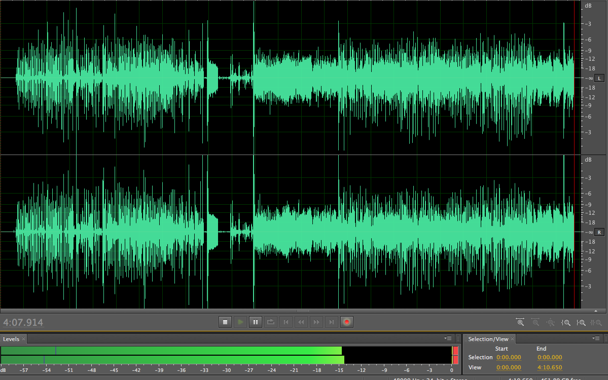

    ok, i've uploaded a screen. need more pro eyes on this... i'm frustrated because i can't seem to get the bulk of the audio recorded at a higher level because there are little bits here and there that get clipped. do you think this looks sufficient for old basement band recordings on cassette i'm trying to digitize and improve?

    I would say if you only have a handful of spikes (pops, ticks, clicks, glitches) and the rest is fairly even level, don't sweat it (bring up the level in capture/recording). Then after-the-fact, manually remove those spikes (through editing/replacing waveforms, manual microscopic waveform redrawing, or more automated pop/tick removal dsp/filters).
    If there are more than a handful, keep the level lower (like I said earlier) during capture/recording, THEN remove the spikes, THEN raise the level.
    Once again, a good reason to use higher bitdepth. Of course, your hardware has to support it as well (I was assuming that, but thought I'd better mention it just in case).
    P.S. Other than the spikes, the waveform looks fairly decent; no real clipped sections.
