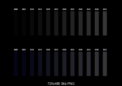

  6. Note when I say it's normal for LCDs to have a blue tinge in their blacks I mean something like the bluish bars in the lower part of this image compared to the pure gray bars in the top (and the pure black background):
