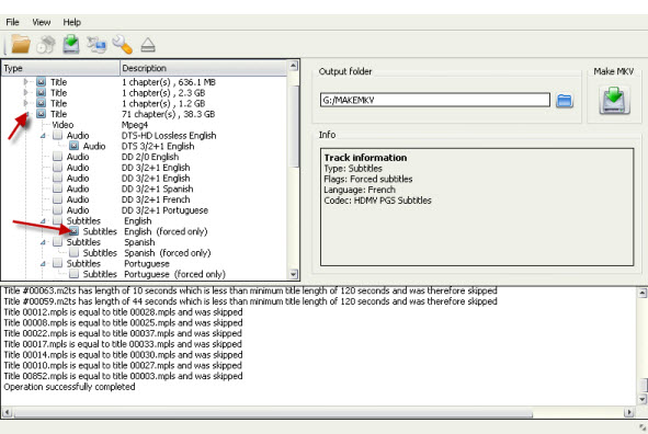

    If your using MakeMkv in the drop down list of files where you select the the language and subtitles dont check the box for subtitles but check the box below it that says forced subtitles for the language that you want.This should give you an mkv with the forced subs in it.

  11. Member fatbloke88's Avatar
    May 2006
Name:	17-02-2011 18-45-40.jpg
    when make mkv has scanned the disk you get the screen above with squares for each title if you look infront of the box there is a small grey arrow click on this to reveal the contents of your selected title then select forced subtites.

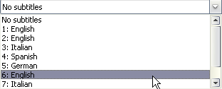

    found an easy(if expensive) way of doing this by ripping the entire bluray to the hard drive with anydvd,then open the bluray in TMPGEng video mastering works 5,select the main title.

    Now in the dropdown box where it says no subtitle select a subtitle track in the language you want,then press playName:  22-02-2011 08-41-40.png
    scan through the film till you see subtitles to make sure they are the right ones,if not go back to the drop down box and select the next subtitle track and press play, do this until you find the correct sutitle track,then check the small white box next to the video window and press next.It will now ask to import the chapter information.
    Next choose a format to rencode to(I chose mkv) and rencode the video.
    you now have a video with the forced subs hardcoded into the video,after a lot of experimentation and reading different forums,it appears that most software players can't see the forced subs even if they are there hence the need for rencoding.
    This was the easiest way I could find as it lets you preview the film wth the subs, without having to process the files first.
