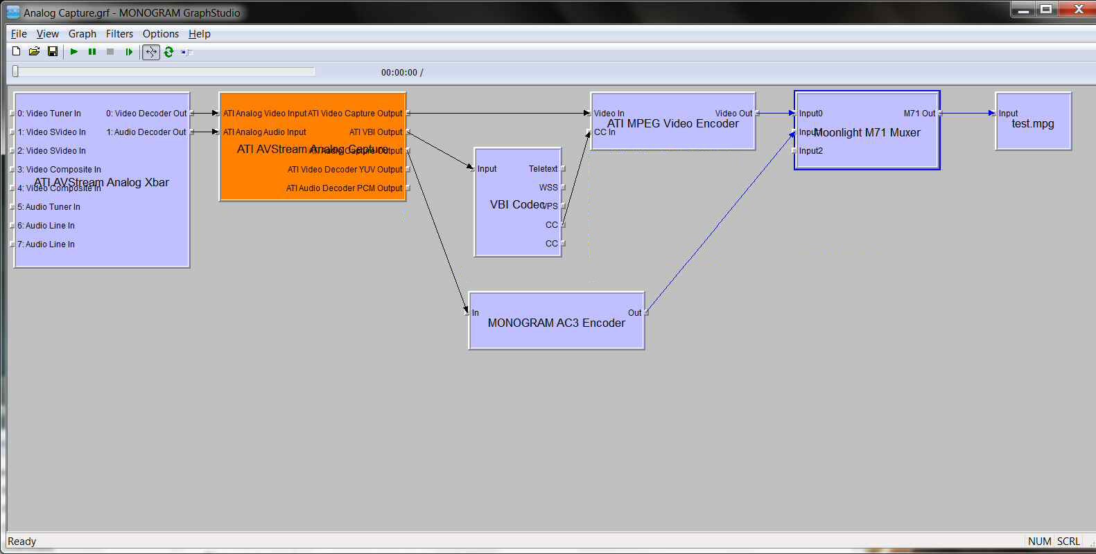

    You could try building a graph with GraphStudio. This is one I built for my Theater 650 PCIe card.
Name:	Diamond 650 S-Video Capture Graph 2.jpg
    I don't know the names of the ATI XBar and Stream Analog Capture filters specific to your card, but perhaps they will be close to the ones for mine. I think Catalyst Media Center provided the video encoder. Installing DVRMSToolbox provided the Moonlight M71 Muxer and the related Moonlight DumpPos filter (the last filter in the chain, which creates the capture file). Microsoft provided the VBI Codec filter, if you want to encode closed captions. Either DVRMSToolbox or GraphStudio provided the Monogram AC3 Encoder, I'm not sure which.
    1. Open GraphStudio.
    2. Click on "Graph" in the menu bar, then "Insert Filter", on the drop-down menu.
    3. A dialog window will appear. There is a drop down list near the top left corner of this window that provides access to various filters. Open the drop-down list.
    4. Go down the list and click on WDM Streaming Crossbar, hopefully you will see something like "ATI AVStream Xbar". Add that as the first filter in the graph.
    5.Open the drop-down list again. Look for "WDM Streaming Capture", and click on it. You should see something like "ATI AVStream Analog Capture" Add that as the second filter in the graph.
    6. Open the drop-down list again. Look for "DirectShow Filters", and click on it. You should be able to find the rest of the filters in the graph if you have the the installed the software mentioned previously.
    7. Drag and drop to connect the pins as shown.
    8. Configure the properties in the XBar filter to use the inputs you plan to connect for capture.
    9. Configure the properties in the ATI MPEG Video Encoder filter for the encoding setting.
    10. Configure Moonlight M71 Muxer's properties to output either a program stream or a transport stream.
    11. Once you have the graph and the hardware set up, click the green arrow in the toolbar to start the capture. The square stop button turns red when the capture begins. Clicking on it stops the capture.
