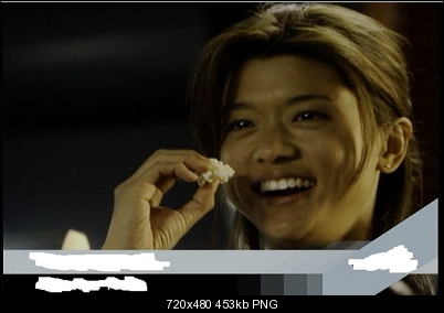

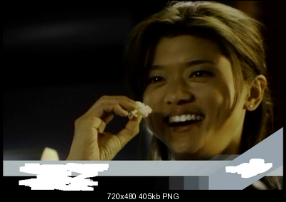

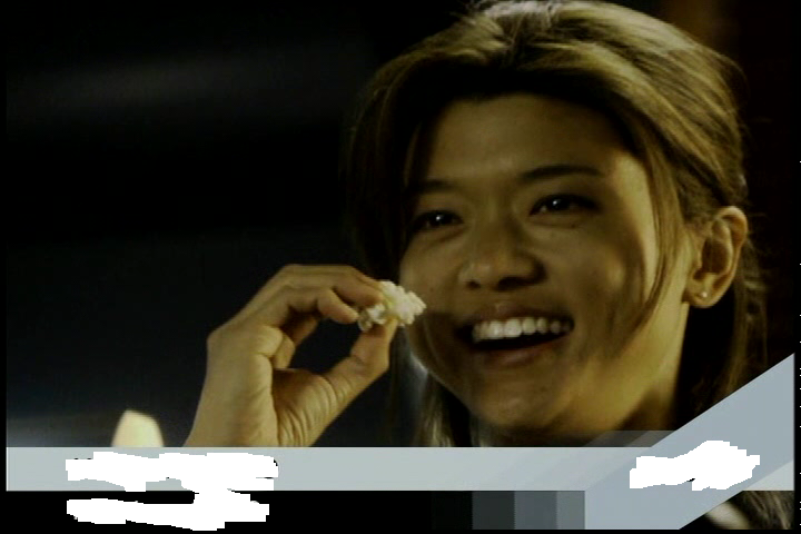

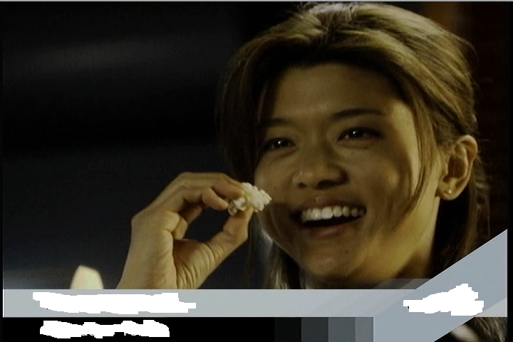

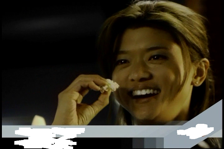

    This is the same pic as before, only done with VDMod (the Hawai 5-0 ad). Again, logos are manually scrubbed, and no copyright infringement is intended - only demonstration.
    Hauppauge 1950:
    ATI 750:
    ATI 600:
    Notice the higher detail on the 600 again? As well, Hauppauge captures always seem to be softer and less detailed (although less blocky, but that comes with the territory).
    Keep in mind, all captures were hard-teleclined, so only chose a progressive frame.
    I hate VHS. I always did.

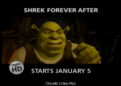

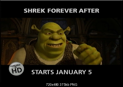

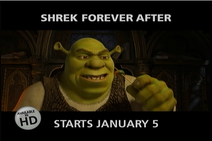

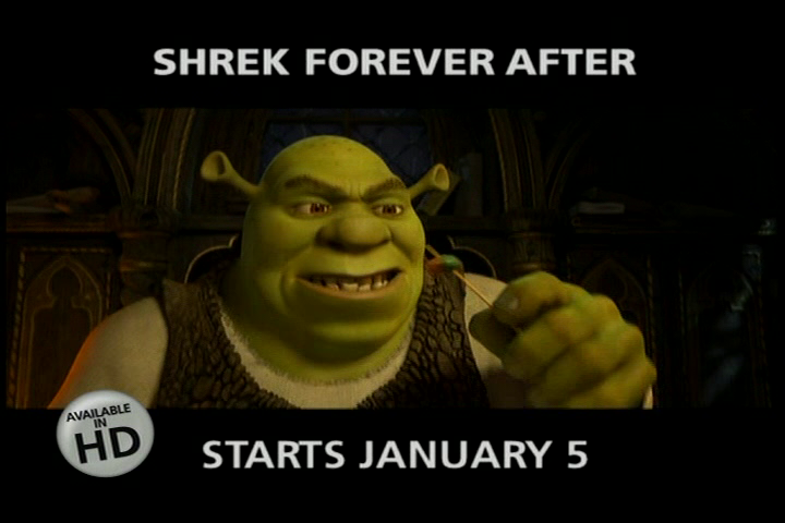

    Another demonstration, particularly for animation fans. This is from an ad for Skrek Forever After. Again, only demonstration, no copyright infringement.
    Hauppauge 1950:
    ATI 750:
    ATI 600:

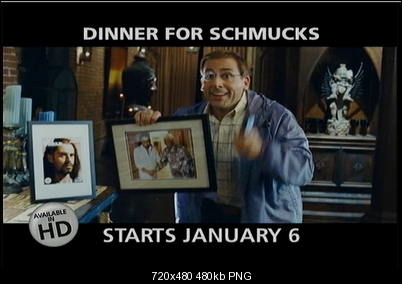

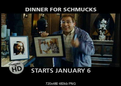

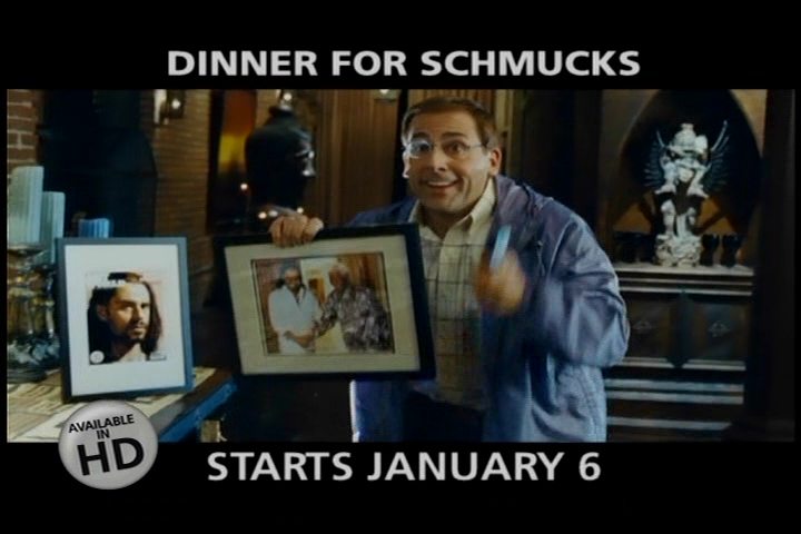

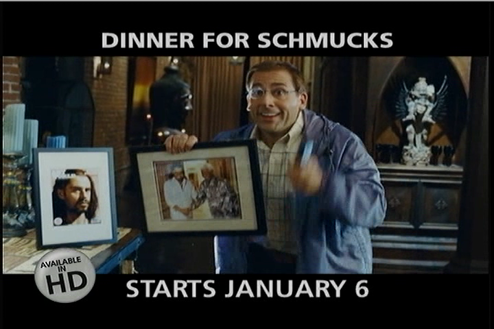

    Again, another. This one from an ad for Dinner for Schmucks. I chose a frame that had some motion and alot of detail. Again the 600 wins handily IMO.
    Will always say this -> no copyright infringement is intended. Only demonstration. Thank you.
    Hauppauge 1950:

    ATI 750:
    ATI 600:
