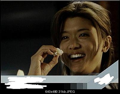

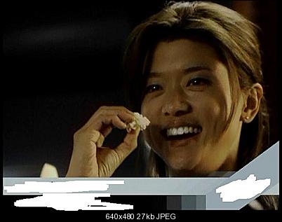

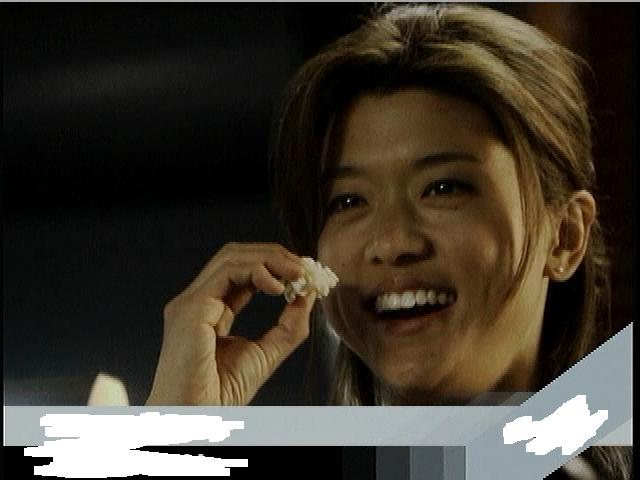

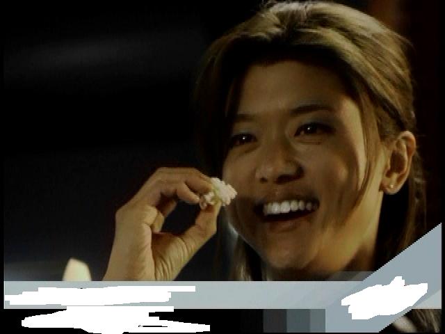

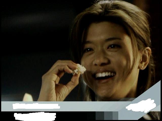

    In a nearby thread I conducted a comparison using a TV capture from a preview station that runs the same advertisements over and over again over a ~10 minute cycle. I used a Hawaii 5-0 frame then, so I will use a similar one again (although this one is older and has logos of which I blocked out). I mean no copyright infringement, only demonstration.
    I captured to BMP, then converted to JPG for the Forum to accept them. I compare the Hauppauge 1950, the ATI 750, and the ATI 600 at roughly the same bitrate. This was done late 2010 (when I had all three in my possession). I used Beyond TV PVR software for all three so any difference could be the same. All are in MPEG-2.
    In my conclusions, the Hauppauge was least blocky, but also the softest and least detailed. The 600 had far more detail than the other two. The 750 was the worst in artifacts, inconsistency and audio even, although it seems to capture more detail than the Hauppauge.
    Hauppauge 1950:
    ATI 750:
    ATI 600:
    I hate VHS. I always did.

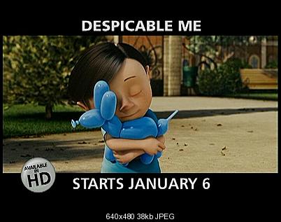

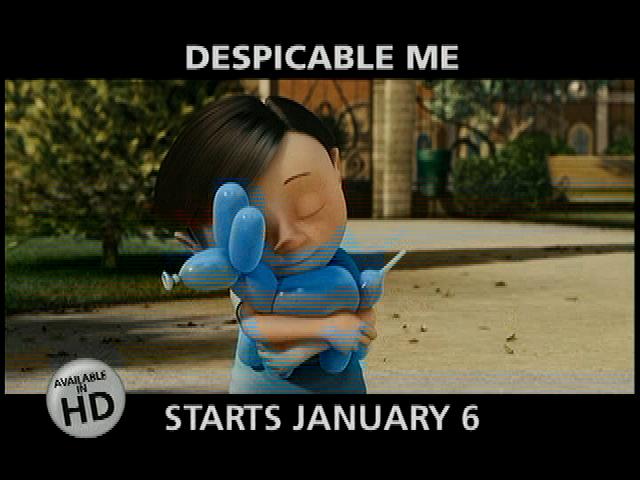

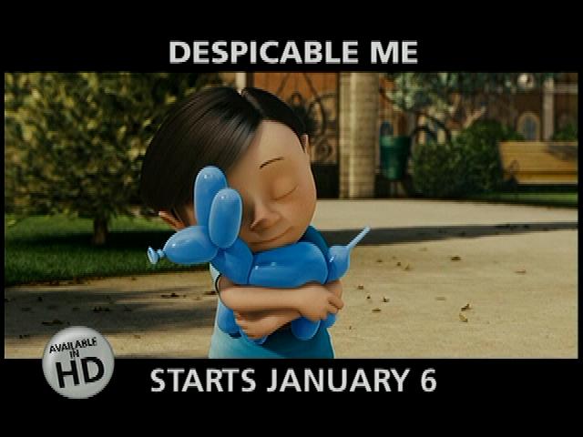

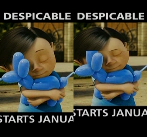

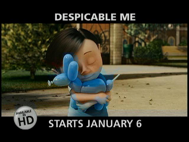

    Jagabo, I'm not sure if this will be considered an AGC issue, but certainly one of inconsistency. I have several of these from the 750.
    Again, this is from samples in late 2010 over a recurring station demonstrating pay-per-view options and ads. Again, it's in MPEG-2 and captured with Beyond TV.
    Here's one from the ad for "Despicable Me". Again, no copyright infringement is intended, only demonstration.
    There are three adjacent frames (you will notice the slight movement). Look at the color explosion and bleeding in the middle one. This happened lots with the ATI 750 when my other ones never did in the same setup using the same captures.
    Frame 1:
    Frame 2 (next one):
    Frame 3 (next one):
    Here is the clip with about 14 frames demonstrating it. It shows well played in WMP with Play -> Repeat enabled.

  24. Originally Posted by PuzZLeR View Post
    Interesting you mention that a DV -> MPEG-2 encode produces a better result than a direct MPEG-2 capture. Even with a good MPEG-2 encoder I tend to initially disagree with this. However, I would be glad to run this test with the ATI 600 out of curiosity if so.
    I can produce examples of the output of various hardware MPEG-2 encoder devices compared to the results of the Canopus + HCENC to demonstrate the point if need be.
    Certainly.
    I don't have time now, but I would like to test this myself too within the next couple of days in my setup. I will report back soon.

  27. Originally Posted by PuzZLeR View Post
    This is unfounded my dear friend. To say you "think" is not to say you "know".
    I thought I remembered someone around here saying the 600 had the same AGC problems as the 650 (which I have).
    Jagabo, I'm not sure if this will be considered an AGC issue, but certainly one of inconsistency... Frame 2 (next one):
    [Attachment 5633 - Click to enlarge]
    That's not a AGC problem. The card lost several lines of one field and the rest of the field has shifted up. Crops from the two fields bob deinterlaced:
    In your sample you improperly deinterlaced theYV12 frame causing the colors of the two fields to co-mingle.
    The AGC problem I speak of usually occurs at shot changes. For example, when there is a dark shot and a sudden shift to a bright shot, the bright shot is over-bright (washing out the brightest parts), then over the next several frames it darkens to normal levels. This was from several VHS tapes I was testing on the 650. The other capture devices I tested (Hauppauge HD PVR, Hauppauge PVR-250, Panasonic DVD recorder, Toshiba VHS/DVD recorder combo) didn't have the problem.

    Hi Jagabo, thanks for your feedback regarding that sample.
    It's just that bad reports of the 750 and 650 may hamper views of the 600, when in reality, the 600 is a totally different device. It's like two brothers being punished at school for misconduct, but even their third brother, who may have done nothing wrong, is punished too, due to family association not accomplice.
    Well, I'm not married to the 600 and am willing to see if this is true or not true regardless. If you want to test a 650 against the 600 that can be arranged.
    That's not a AGC problem. The card lost several lines of one field and the rest of the field has shifted up. Crops from the two fields bob deinterlaced ... In your sample you improperly deinterlaced theYV12 frame causing the colors of the two fields to co-mingle.
    Got you. I didn't think it was an AGC problem myself, but got alot of that with the 750 - using the same system for the 600 and the Hauppauge which were not guilty of this.
    However, I did no deinterlacing, or change any settings within BeyondTV, so I don't know how it kept happening. As well, there were alot of audio dropouts too.
    Then again, this seems to be a common problem with the 750.
