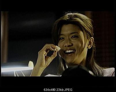

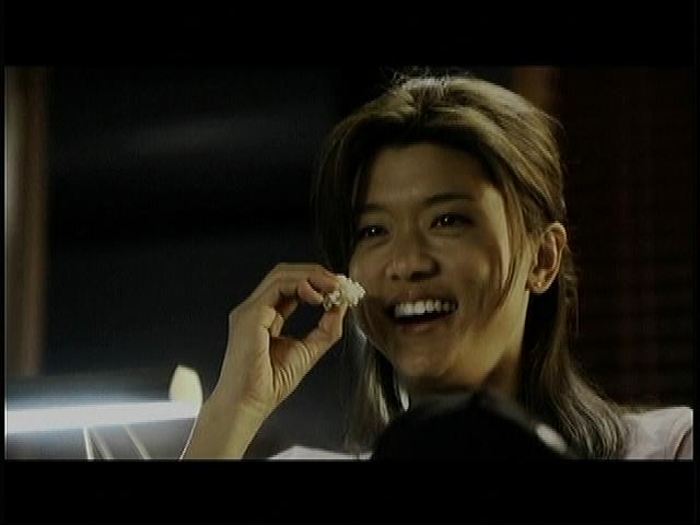

    Ok, here are some TV captures from a recurring station that previews the same advertising segment every 10 minutes or so. This is an ad for the current Hawaii 5-0 TV series - no copyright infringement is intended. It is only a random pick for demonstration purposes.
    I have used MPEG-2 with the Hauppauge 1950 and the ATI Wonder 600 at roughly the same bitrate, which was about 8200kbps. The DV was captured with VirtualDub via the ATI Wonder 600. Although not conclusive, it should give an idea.
    Hauppauge 1950 MPEG-2:
    ATI Wonder 600 MPEG-2:
    ATI Wonder 600 DV:
    The Hauppauge capture clearly is softest.
    The ATI's MPEG-2 has similar detail to the DV, and noticeably more than the softer Hauppauge capture, but with movement has a few more blocks than the other two. However it does have more details per bitrate than the other two.
    The DV is arguably the nicer capture in both ways, combining the best of both MPEG-2 captures - detail and less artifacts. However it's several multiples in file size.
