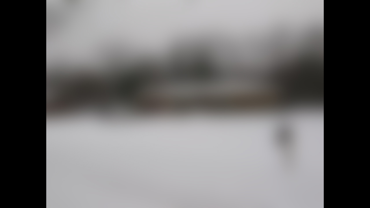

    This is what it looks like when I add the video to the timeline:

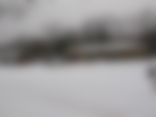

    This is my original video:
    Because 720 is greater than 480, there should be a black area above and below the video in addition to the left and right side of the video. However, Vegas is resizing to fit the 1280x720 frame.
    How do I put a 640x480 video into 1280x720 without Vegas resizing the video?

    Not sure if this is the correct method:
    Open pan/crop. Under "Position", change width and height from 640x480 to 1280x720. This reduces the video size but not sure if its making the video go down to 640x480 or another size.

    Edit : re-read post. Yes, use Event Pan and Crop and described above to reduce the size to 640 x 480, then use Track Motion if necessary to centre it in the 1280 x 720 frame.

    Deactivate "maintain aspect ratio" and "size about center", use the zoom slider to reveal more workspace, enlarge the crop rectangle so the top and bottom of the 4:3 video is the size you want, then expand the crop rectangle left and right to widen it, then slide it left to right to position the 4:3 video.
    Once you do it once, it's very easy, you'll see. You're basically doing a "shrink" or reverse zoom then a reposition.
    Track motion works too, but it's an extra step and you have to keyframe it back to default if there are any more videos on that track.
    Like This:
    [Attachment 5546 - Click to enlarge]
    To make the video smaller, make the crop frame larger:
    [Attachment 5547 - Click to enlarge]
    The video will always have the correct AR no matter the size.
