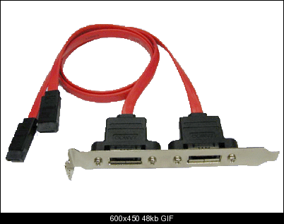

    External eSATA drives have the advantage of operating at the same speed/performance as an internal SATA drive. If you have a spare SATA connection on your motherboard, you can just use a eSATA PCI slot adapter, then a eSATA cable to the new drive. Only takes a few minutes to install.
